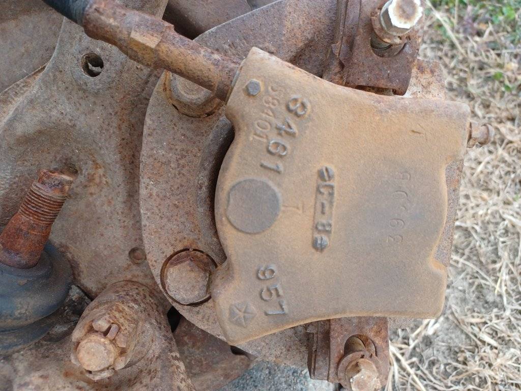

I have 2 sets of what I believe are C body disk brakes. One set I believe is from 68 and the other is from 73. I believe this because of the style of rotors they have. The attached pictures are of the early ones. Any help will.be greatly appreciated.
Those would appear to be '69-'73 single piston calipers from a C-body. '68 still used Budd dual piston calipers. If the rotors are 11", that is a c-body setup.
