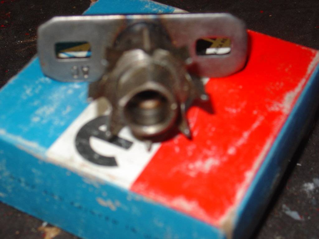

Hey do you have the funky cast reluctor looks like knife ends by chance?

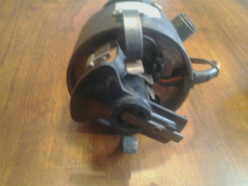

Yes it is a MP one kind of special used for race applications, completely different animal. Surprised you have that usually found in tach drives. I might have a rotor that I can get a number for you from. If it looks like this goes into a aluminum Prestolite case so you will need a Prestolite style cap and rotor. Shoot me a pic with the cap off and the old cap if you can.
