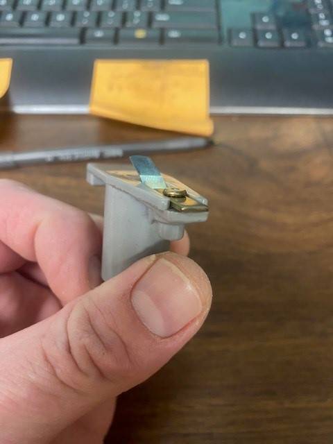

The distributor is just a stock mopar electronic unit as far as i can tell, it came with the motor which is a 78 400 that i swapped into my 67 fury. All the lean burn stuff was already gone. Not sure if the distributor was different for lean burn but this unit looks like a standard electronic unit (sorry i am really a chevy guy). Yeah i may have to give MSD a call, that is what the wife suggested. The upper part of the shaft where the rotor goes has about a 1/16" of up and down play but i do not see the lower part of the shaft that goes into the engine moving at all and i have another unit from a 440 and a electronic distributor on the 318 that came out and they all have about the same amount of play on that upper shaft. That being said i cut the cap in half so i could see and even when lifting the upper shaft up it still is almost a 1/16" from contacting the cap terminals as that was my first thought was the rotor was not down far enough (i will grab a pic of this in the morning).

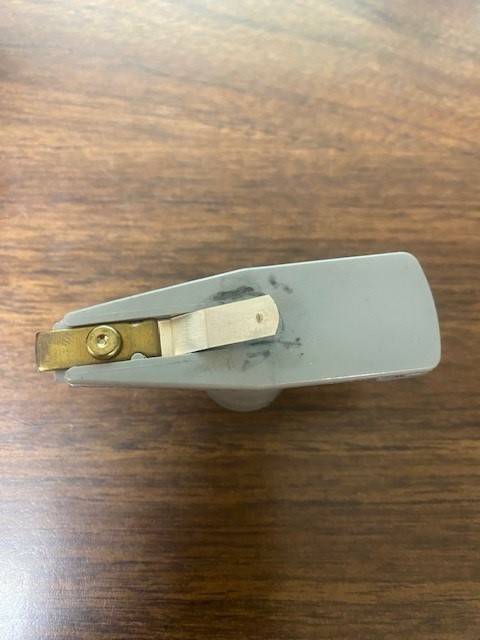

Here is a pic of the rotor that came with the cap in the above pics:
I would think I would see some sort of wear on the rotor if it was indeed hitting the cap terminals. I have not turned the distributor in a lathe but i can next week at work.
@halifaxhops where do you think you see a slight score mark?

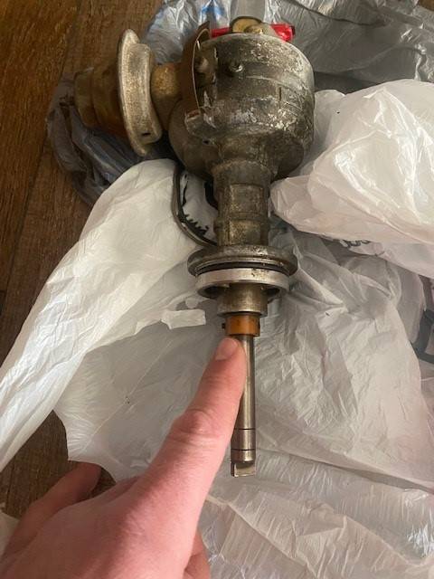

@volksworld what plastic spacer are you referring to, would it be this one at the bottom of the shaft (this is the 440 unit)? If so i will pull the distributor out in the morning and take a look. Something i did notice is that the contacts on the Blue Streak cap extend past the molded plastic (lower) while the contacts on both my 318 and the old 440 unit seem to be flush with the plastic. Thanks for the replies everybody i will get this pulled out in the morning and dig into it deeper.

Later model rotor for sure. The play is the advance springs. it should basically drop on the shaft. I bet the center carbon is worn also. Look at that link I posted you will see it right away. Looks like a 303 rotor to me. is it hard to put on the shaft?

yes thats the bushing i was referring to...
also...down in the bottom of the hole of the rotor shaft there's a C clip to hold the upper piece to the inner one that it pivots on when the timing advances....cant remember right now but i think its hidden by a piece of felt (that holds a bit of oil)

I don't think that's wear. The tip of the rotor would be destroyed if it were hitting that hard and the burrs would be off the contact in one direction, away from the rotor's rotational direction.
I think what you are seeing is burring left over from the machining operation when the cap was manufactured. To me, those look like the typical burrs I would expect from the contacts being cut.
Can you positively say "it didn't look like that when I put it in"?
I have seen new caps with that burring brand new in the box, although usually not quite that bad.
