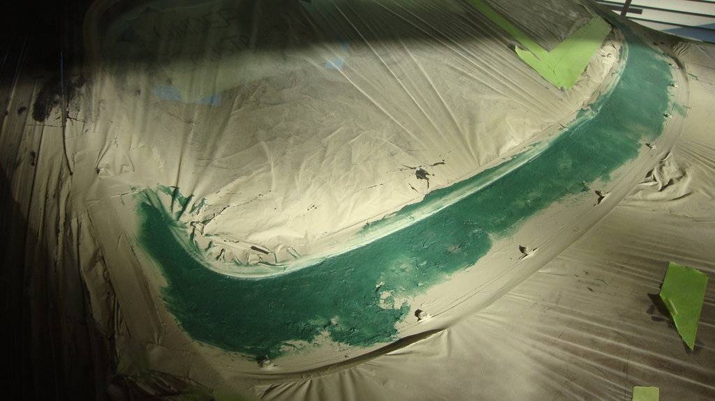

DIY $40 make you holla fiberglas radiator shroud with bondo kit

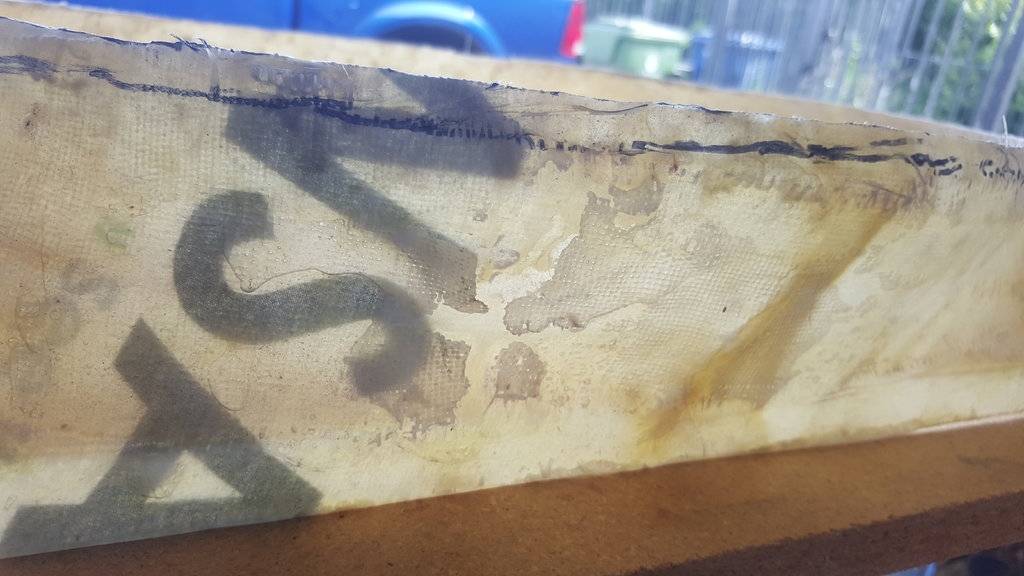

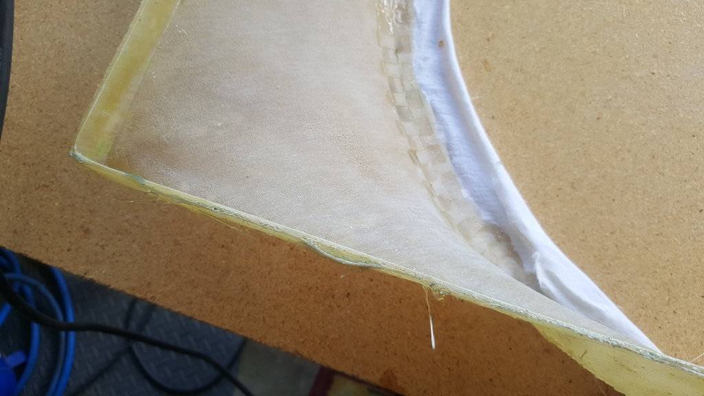

View attachment 131909 thickness = good
air bubble = bad
View attachment 131910 air bubble = really really fknig bad.. kids dont let air bubbles happen. either fix it at the moment, or remove the offending piece and try again.
you can grind that out, cut a piece of roven and resin it in. It wont hurt the structure and will seal it up so moisture doesnt become an issue.

well today was a 50/50 day... i won some and i lost some.

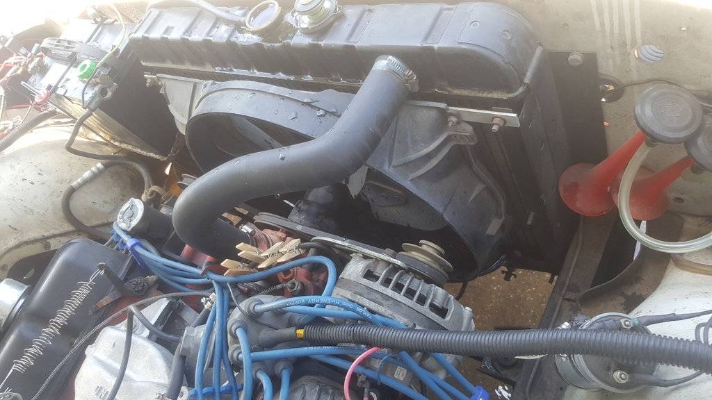

here is the current shroud that will be changed

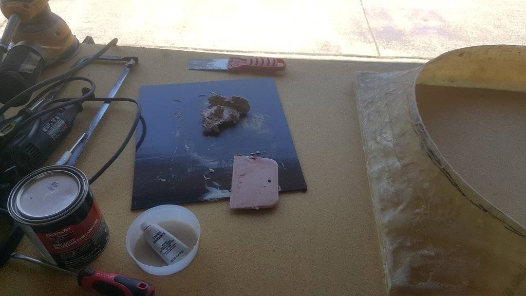

i tried bondo filler and did not even make it off the mixing table with the stuff. is it too hot in TX? too much wind? too much hardner? i didnt even get it mixed.

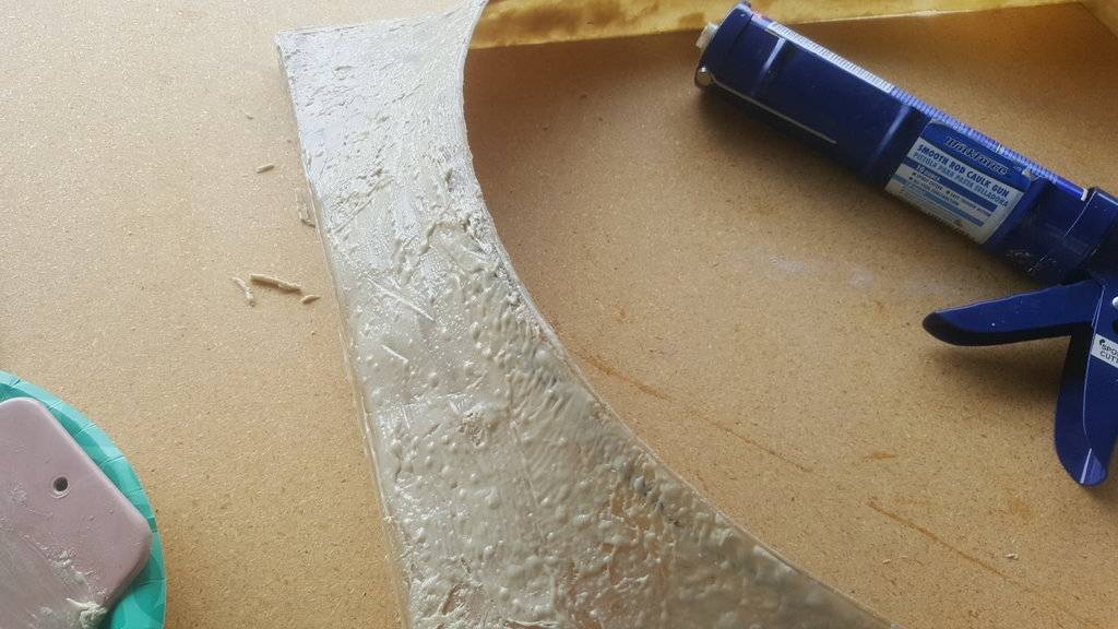

then i tried my trusty PL30 as a filler.. i think this is gonna be another fail. it looks like the pl30 is not binding to the glass layer, and air bubbles are popping up like zits. i think im gonna have to sand it all off. i got about halfway and noticed the start point was all janky looking . . .

Pl expands so without being pressed between two surfaces, it will continue to expand and bubble like that... no good as a filler.
Bondo is the same chemical cure as fiberglass resin, doesn't air cure but from a chemical reaction. Too much catalyst (red stuff) in the filler (grey stuff) will make it cure too fast... also, the chemical reaction creates heat and can burn if you aren't careful.
I go a little hotter than MarPar but yea, about a 1 inch line of catalyst to a golf ball of filler.
