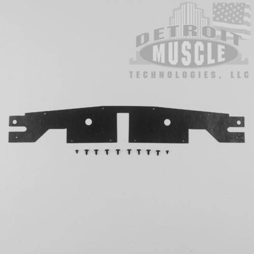

Has anyone ordered/installed the DMT "1969-72 C-Body Dodge Polara/Monaco Lower Valance Radiator Splash Shield"? I forgot to start the installation before I put on the bumper and lower valance. For the life of me, I can't figure out how it's supposed to go. It certainly doesn't look like it fits or is cut right for my 70 SF.

It certainly doesn’t seem like it. I have no idea why they sent it to me then.
You ordered one for a Fury and they sent you that?
Many vendors think 70 C body means things fit across the board, they dont
I put one on my 300 that looks just like that. Fit perfectly.

The splash shield DMT shows for the Fury looks different from the one you have.
DMT MOPAR 69-72 C Plymouth Fury Gran Fury Lower Valance Radiator Splash Shield | eBay
The Monaco one looks similar to the one that I got for my 300. But thinking about it... I bought mine from Vans, although I also bought some other shields from DMT. I made a couple too using the old ones as patterns.
DMT MOPAR 69-72 C Dodge Polara Monaco Lower Valance Radiator Splash Shield | eBay
Give them a call. They are one of the best vendors to work with. Perhaps they sent the wrong one.
I've always had good luck with DMT, they stand behind their product.
As a follow up, I just spoke to Jim at DMT. He said that he just recently discovered the difference. Apparently someone restoring a 70 GT SF who is going to MCACN with the car (he didn't mention a name so I'm not sure if it's someone here on the forums or not) sent him a NOS set of them. So he had the tooling redone and it's on the way. So, he should have the correct pieces for a 1970 Sport Fury or Fury in a week or so.
The part numbers are different, he didn't know? I seem to recall a discussion on these a few years back.
Well, he said the parts diagrams or whatever for MOPAR, compared to other makes of cars, are terrible. So while he might have known, I don't think he had them exact. Regarding the 2 pics above, I don't think the one listed currently for the Fury is correct either. That area near the radiator is just different than the stamping on those.
