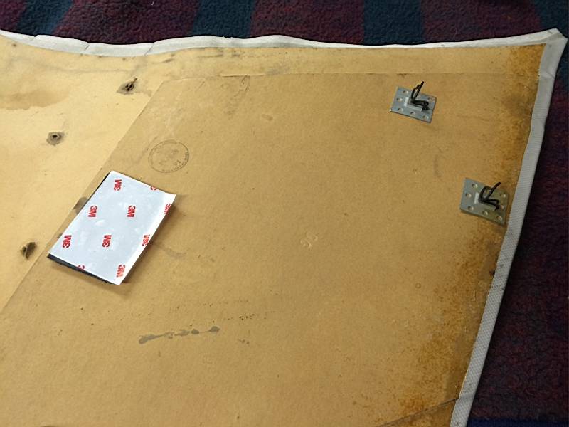

I have a few questions that maybe someone else figured out. So I redid my door cards on my 68 300. I don’t know how I messed up but now none of the clips match up with any of the holes in the door. I was thinking drill new holes in the doors to match the cards. I spent a lot of time remaking the cards and don’t want to risk screwing up the vinyl.
Has anyone had any success with something other than these awful clips? Like adhesive or I think someone said Velcro? Not going to be removing them 40 times a day so any suggestions??

Nope. They’re lining up in the middle of holes on the door. And the bottom ones are about 2 inches too high. The original cards were really messed up so I kinda had to wing it with tracing it out on the new one

Magnets. I've done this and it works great.
Buy a bunch of thin ceramic magnets and glue them on the board. Still gotta have a couple clips to locate and help keep in place. About 25 magnets per card with a few clips.
Did not even think of magnets. Still gotta drill a couple of new holes. But it’s not going to be the 14 it has

I don't think drilling new holes would be huge issue, you'll never see them anyway. But if the bottom ones are 2 inch higher you may not get the seal at the bottom and have a gap. May end up a combination of that and the magnet or velcro option.
