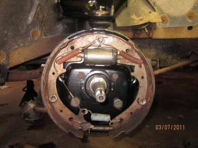

Dragging rear brake shoes, drum brakes 11x2.5

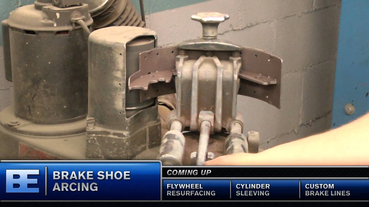

I would buy the lining material, rivet it to the shoes and them arch them to fit the drum. The machine was pretty simple, Set the drum diameter and clamp the shoe down, start the electric motor which ran a grinding stone and manually rotate the lining against the stone until the desired radius was reached. Never had a problem with lining to drum fit.
It used to be standard procedure to arch new brake shoes/linings to match the drums. I had a machine that did just that.
It was a mandatory step when working on cars of the 20's & 30's.

Hey guys, I'm having a similar problem as the OP. My rear brakes (65' New Yorker) seem to be over tight and trying to do most of the stopping. I have rebuilt most of my brake system (new wheel cylinders, rubber lines, flushed & bleed the lines, new shoes, new spring/hardware, turned drums) and everything has been working fine, with the rear dragging just a little more than I feel it should. Last week I had to smack my brakes because of another car, which produced a leak in my booster now (I'll send that off for rebuild this winter). Since then my rear brakes have over tightened an equal amount side-to-side but feel like there trying to do 70% of the work stopping the car. I've read something about changing the self adjusters to a 69+ but I can't find a link to information about this. Can someone throw me a link to this information or offer some insight on this issue? Thanks.

I happened to think about the park brake cable being stuck while I was in the rear drums last night, they're moving freely. As it turns out the rears were not over tight, but definitely doing more than their share of the stopping. I pulled off the driver front and found the adjuster cable bound up and holding the adjusting arm off of the star wheel so it hasn't been adjusting. Hopefully that's my problem on the other side and this clears up my issue.
Okay so I'm pretty sure I got this whipped. I used some (Chrysler) blue paint to spray the inside of the old drum last night. Put it on and ran it a few 10-12 revolutions. Then removed it and found that the only contact seemed to be evenly across the bottom edge of the secondary pad. The blue streaks extended up about 2 1/2 inches. So I grabbed my trusty angle grinder with an 80grit roloc disc and ground that area down and reshaped the pad. (asbestos free shoes) So far So good. Temp ran up to 188 degrees last night after a few panic stops, but stayed down to around 107 on the morning commute. I think it just needs some break-in miles now.
