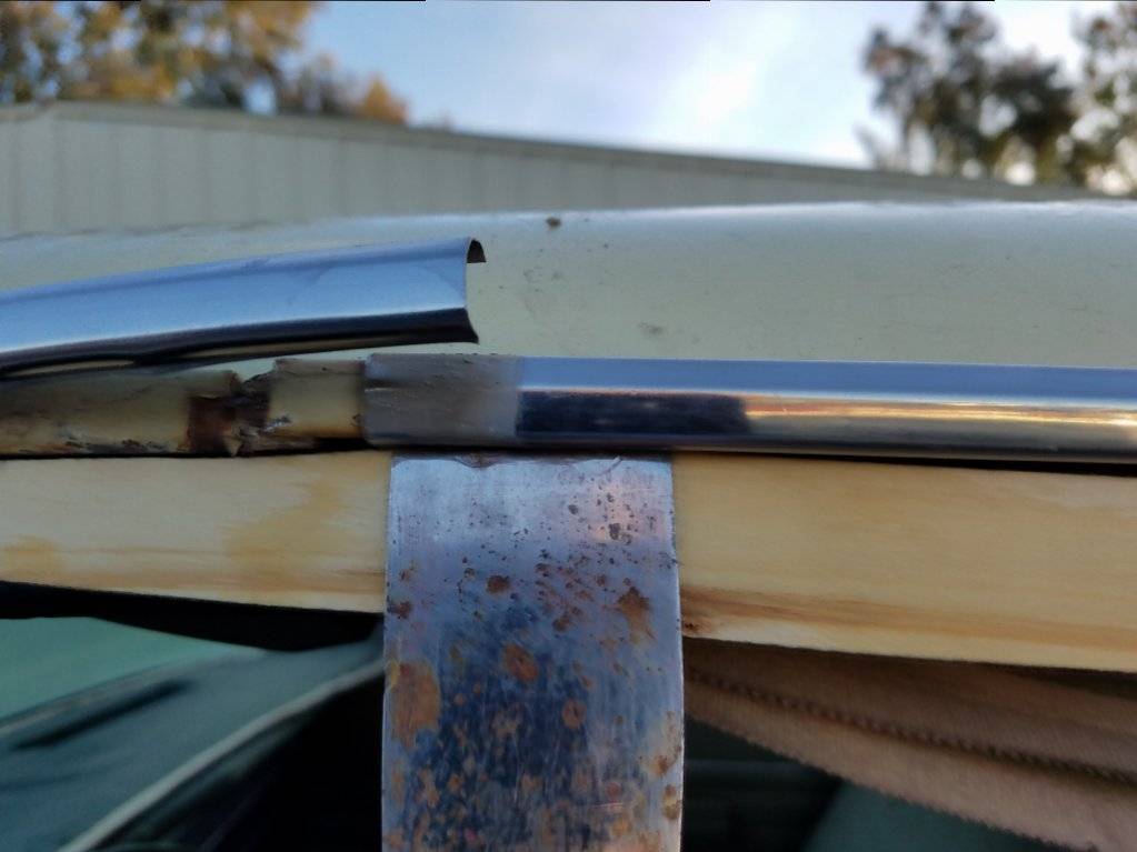

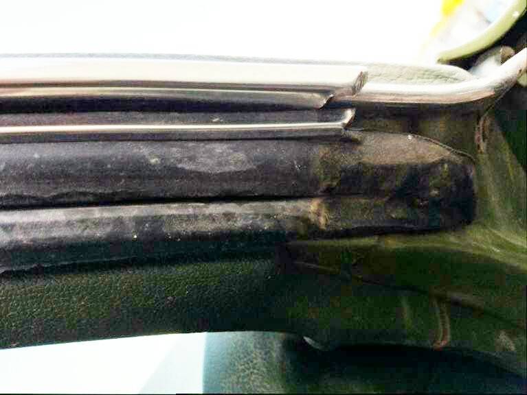

Ok learned something new this morning . the fusey's are different than the slabies. for yours Tom look at Allen's picture. Looks like the weatherstrip has to come out to remove the channel to get to the rivets on the drip rail. on the slabs ides here's a picture showing how you just pry up on the bottom to remove it. I usually a Paint stick to protect where I'm prying.

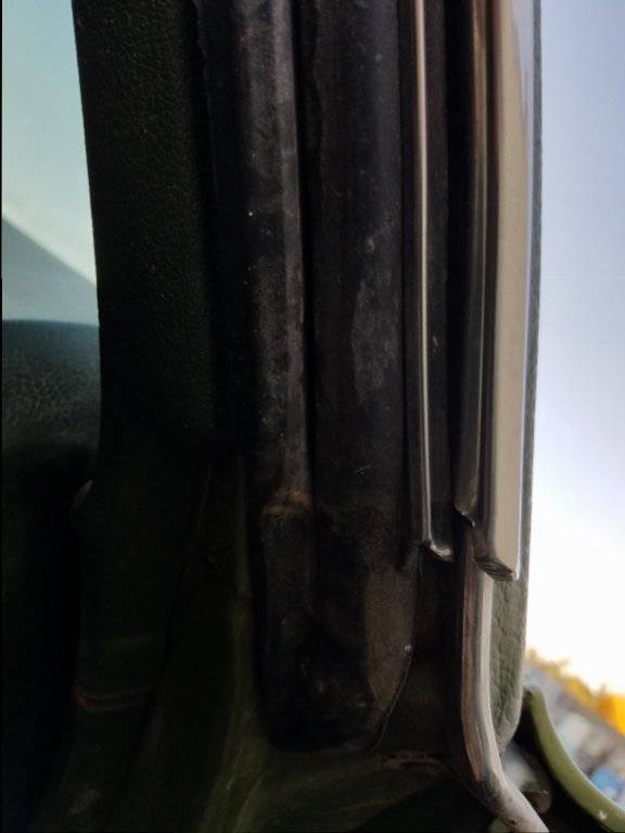

Here's a picture of my 71. The weatherstrip channel must be hiding the fasteners holding the drip rail on.
I'm a visual type of guy. That would help me,
If you look at Chris' picture you can see the bottom edge turns down a little, this acts as a shoehorn when installing them and I had good luck removing the trim by just getting my thumb on it and pulling. Yes a bottle opener works as well but risk marking up the trim.

I guess the next question is, how should I remove the rivets without damaging the trim? I guess drilling it out will be my best option. It's definitely getting screws when I put it back in.
Yes, drill them out. First use a punch to push out the stem if it's inside the rivet. Then since Alan's picture looks like 3/16th rivets use a 3/16ths drill bit and drill them out. If you want to rivet them back in I can fix you up with a rivet gun. Screws would probably work too though.
