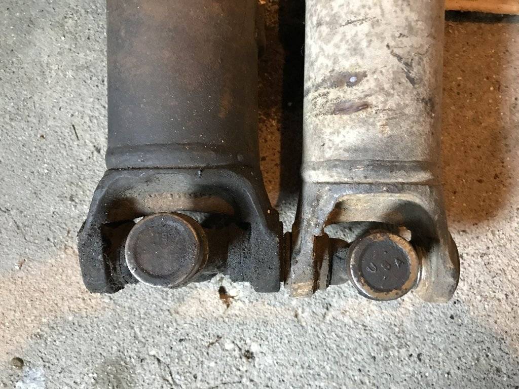

Ok, I am trying to figure out what the difference is between these two drive shafts. One is from my 68 Fury III 4 door, and the other if from my 68 Fury III 2 door fast top.
One is clearly smaller and longer than the other by 1/4 of an inch or so.
Does anyone have any ideas as to why?
Is one of my rear ends different?

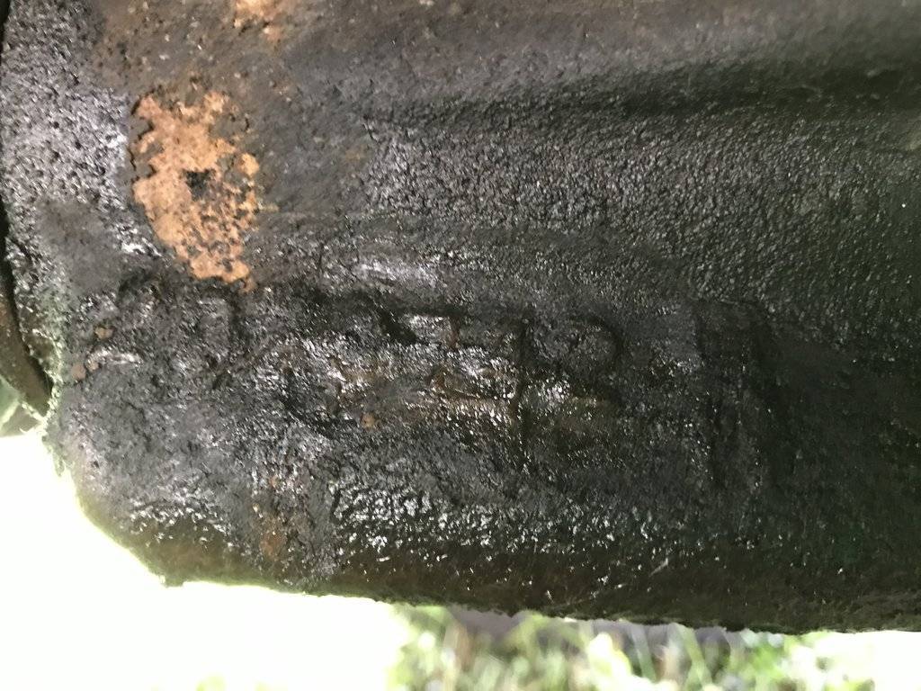

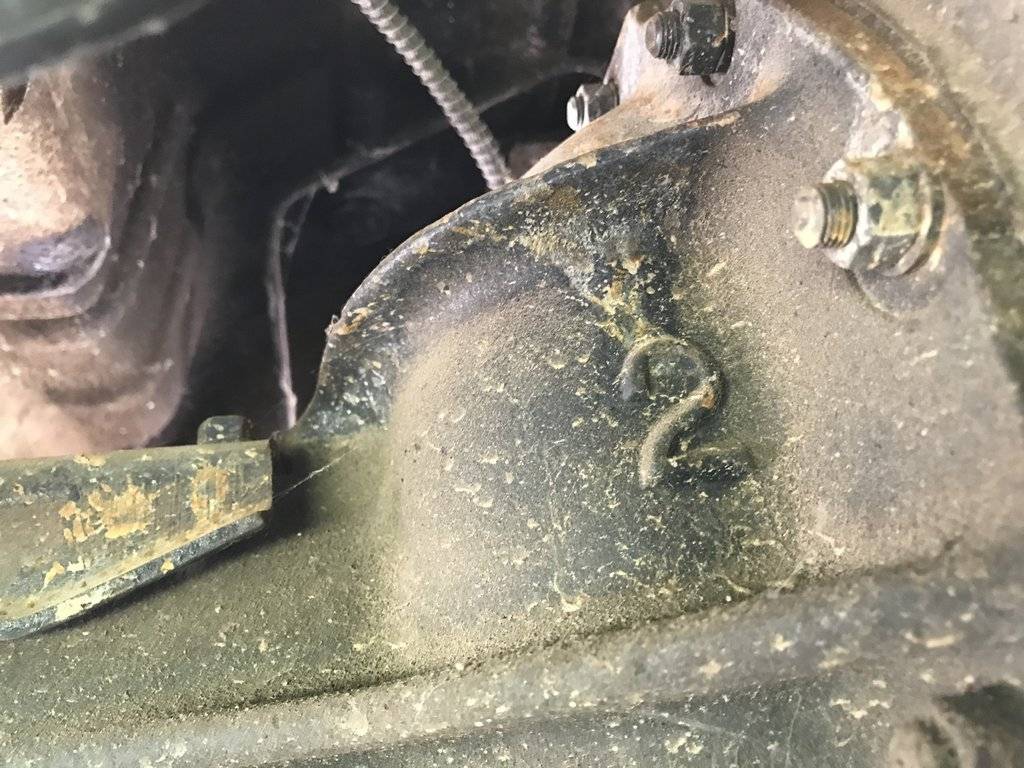

742 large pinion nothing wrong with that. The 1/4" in length difference is not too much of a concern but worth double checking when installed. Either will be fine behind a 383
Thank you man with a hat.
I did a little research and unfortunately neither axles are sure grip. Boo hoo. I'll keep looking for one to put in it someday. For now it's going to have have to be the one wheel wonder!
I did however read in my 68 service bible that the 742 case can fit a sure grip and was an option for that rear end.
What I'm worried about is the difference in size of the u joints at either end of the shafts. I'll do my best to use the heaviest duty one I can since I'm running my new 727specialist trans in there.
Don't want to be leaving gears all over the road or worse, twizzler drive shaft haha!!!
