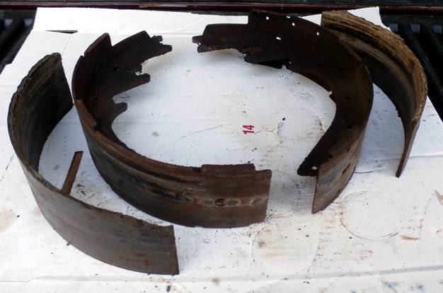

Speaking of problems with drum brakes, this happened to me a few days ago:
Front driver's side brake shoes. It happened in my driveway, I was only driving the car around the circle in front of my house. Wheel seemed to act a little strange. Next day I took it apart, found that the linings had detached. They were probably 3/16 inch thick. I would have put these on new, about 30 years ago. Replacement shoes coming tomorrow.
