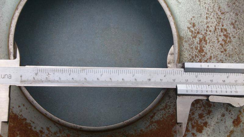

I was unaware, what's considered early?
I'm pretty sure all AFB's, AVS, holley, Thermoquad and Edlebrock carbs will share an air cleaner housing base. The early Carter WCFB 4bbl is smaller.
My carb, and measure of air cleener.
That is an early '70's Thermoquad, and unless there's an adapter under it the intake is also from the '70's. TQ's and Eddy carbs are the same are horn diameter
My guess is. By the way the throttle cable is pulled so far forward on the bracket, it was a 2bbl converted to 4bbl with '70's parts. Also your kickdown lever is Way out of adjustment (needs to come forward).
And thats why the "dual snorkel" is missing, the carb is replaced and the original aircleener dident fit. That was not good for me. I will miss the right stuff. But the Engine seems to run good whit the carb so i must accept beeing the wrong one.
It seems that most factory air cleaners are made to fit the carb they are being used on. The relief on the base is normaly different to allow for linkages and fuel line connections. To get the look you want you may have to change the carb which may mean changing out the intake.

:3gears:When i baught my Polara -67 i was told thats its a 383 4b, and the vin where showing the same. But today i examend the Engine and i could see the number 440 stamped in the block behind the thermostat house, and also the letter J. Maybe the air cleener type dual snorkel dident have room under the hood if the 440 is higher, isnt it called "raised block". Now i am interested in which type of 440 this is. Must search for casting numbers on the block.
aircleaner would fit with a 440, if you had a 383 or 400 that pad by the thermostat wouldn't be there
