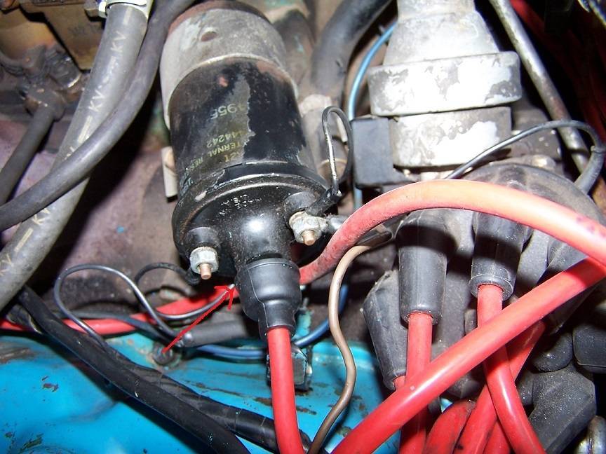

That is what I'm thinking too. It just happens under a load, idle is fine. Also took a peek under the hood today and noticed a drop of oil under the coil (see pic).
So I start with a search for a new coil.

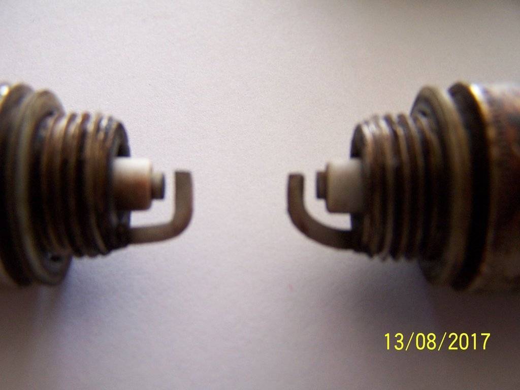

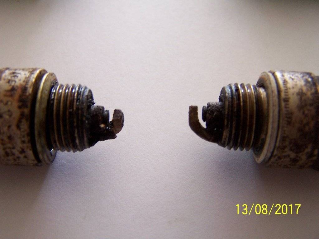

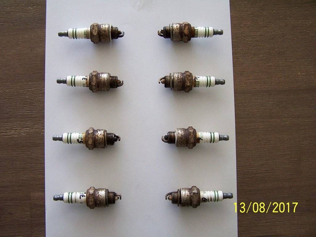

Did some working on the car yesterday. At first I replaced the sparkplugs. First time for me but what a hell of a job !! Couldn't manage to do it from above so, as I read somewhere, jacked the front up one side, removed the wheel and splashshield en voilá: at least I could see those buggers and thats making it a bit easier. Same procedure for the other side ofcourse.
The way the old plugs looked gave me a little hope that I solved the problem, see pics :wideyed:
But after installing new ones, yes Champions, the engine still didn't run well. When revving up slowly engine starts to shake and run rough. With vacuum disconnected at vacuumadvance, and hose plugged, I can rev her up with no problem. That makes me think it's ignition related ? Correct me if I'm wrong.
