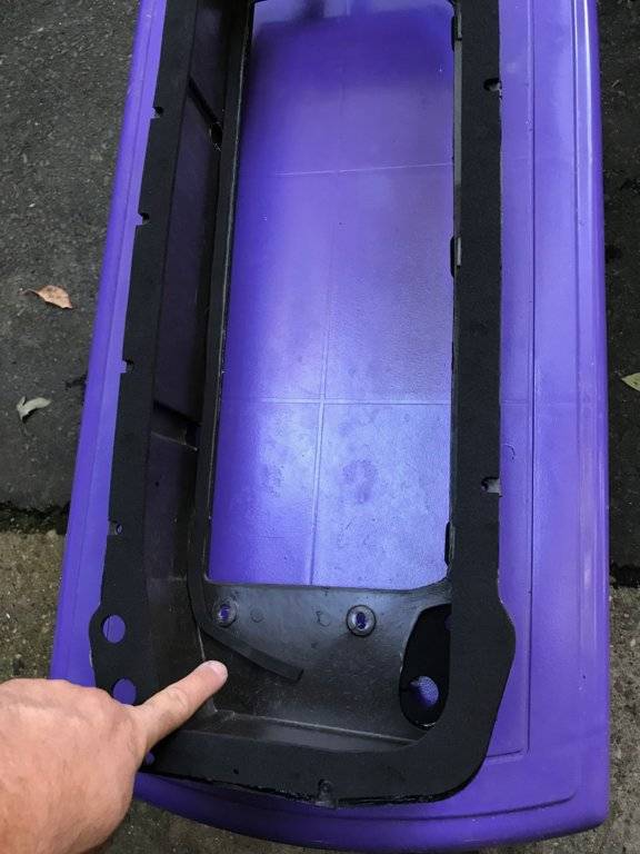

This is an example from my 300, it might not be the same, but the idea is there. There are two gaskets actually, one seals the condenser, the other sandwiched between the haves. I’m pointing to the condenser seal.

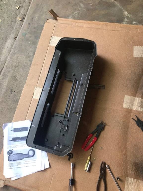

This is the box half that attaches to the firewall, condensation ports are visible below the socket.

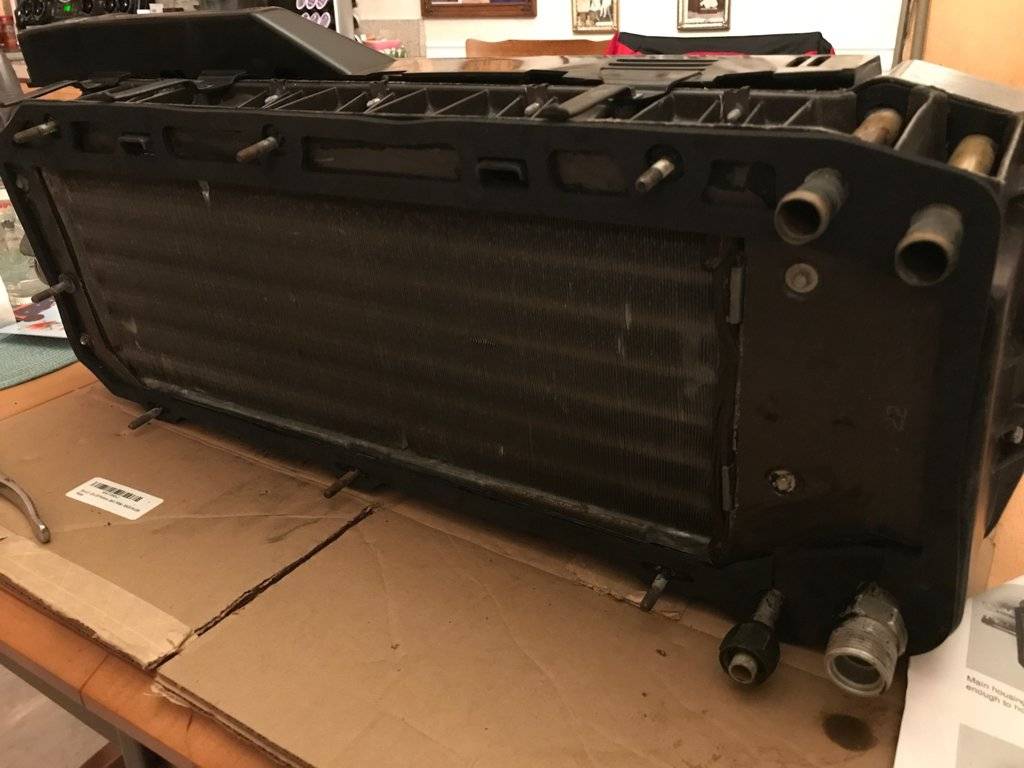

Another view, this is the box upside down, ports are at the top.
This is the passenger compartment cover removed, core is still attached to the firewall. A bead of black 3m silicone is suggested to coat one side of the gasket, that’s why it’s still attached to the other half. If you need a new gasket, DMT will have them at Carlisle.
