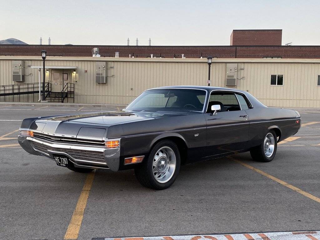

oh yeah, it aint just Mopars. 235/70, 15x7.5, 4.0 in bsp, rubbed on skirt on passenger side.

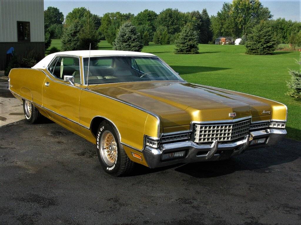

Is that a 73 Mercury? My parents had a 73 Colony Park wagon with a 460 / C-6. It was quite the barge.

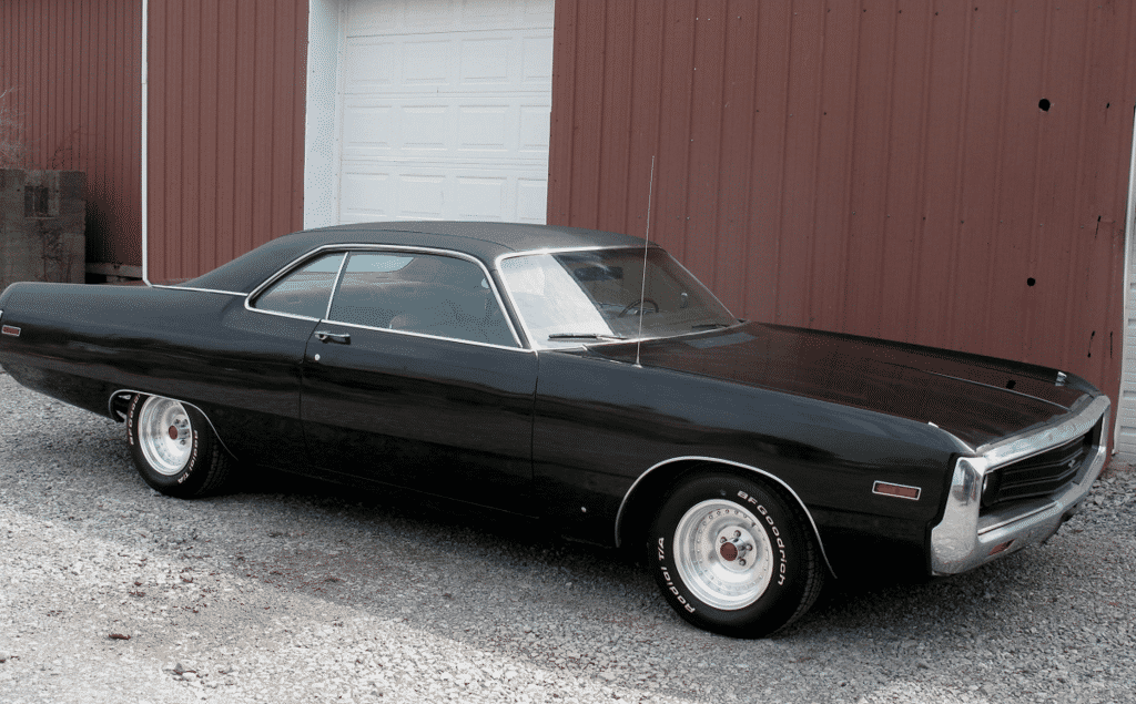

another good example to learn from, but again maybe owner will chime in with backspacing.
Per the specs on the American Racing website my wheels have a 4 inch backspace. They are part number VN50177012500 if that helps. Again, they are 17 X 7 and I have no issues with any interference on the body or suspension front or back.

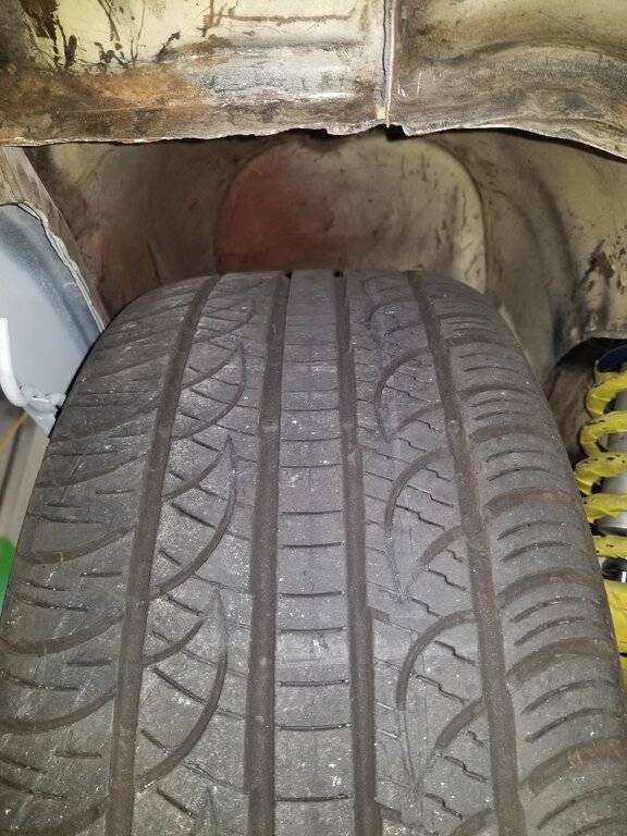

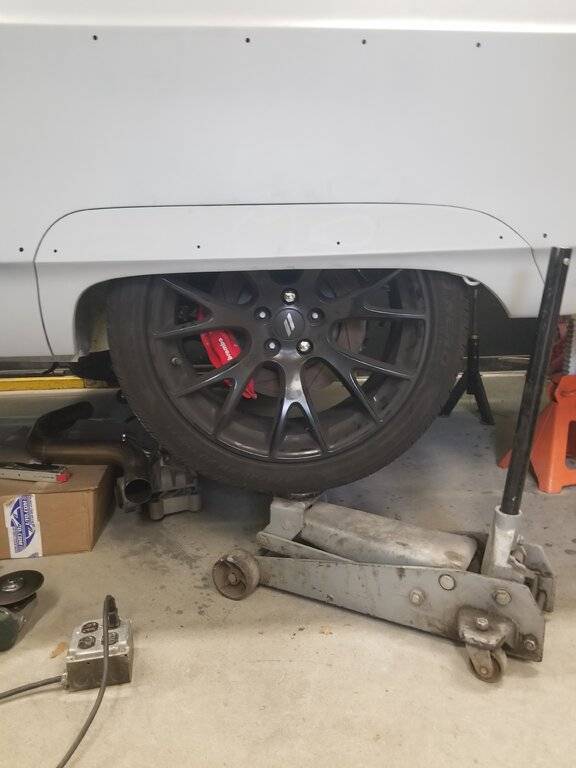

Figured some you you guys would get a kick of this. 275/40 r20. Friend let me borrow his wheels to see if I could get them to fit. Almost no room on the outer lip, but they physically fit. Need a bigger offset to get 295's. Yes, I have issues:realcrazy:

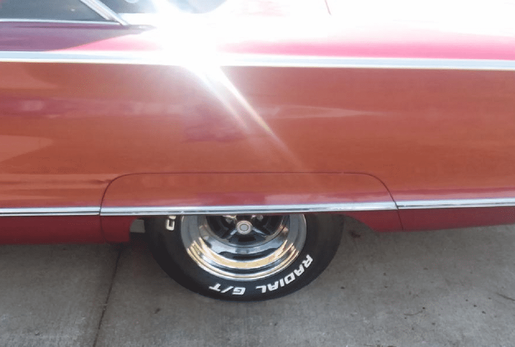

I didn't have a spare tire and was going to get one possibly a Cooper or something that was in good shape. Talking to a buddy who has a 66 Belvedere 440 six pack 4 speed car and he asked me would you be interested in these? He pulled out 2 BFG 255/60/15 tires. He said they rubbed the outer fenders [rear] with his wheels and had very few miles and few burnouts. He said try them on the front of your Fury. Did a little number crunching and yes the are not too wide for 7 inch rims I have up front. The diameter is 27.1 inches as compared to my rear 275/60/15's which are 28 inches. I said what do you want for them? 100 bucks for both mounted balanced and we put one of your 235/70/15's as your spare. He said if you want lets try it out ,drive it for a day and decide. Anyways they have been on for a few weeks now. No rubbing and the minor rubbing problem he had was on the logo side and I don't expose that side anyways. My car ain't no Billboard! It seems to track a little better but turn ins act quicker and much more immediate. I couldn't turn it down for a 100 bucks. Still have both 235/70/15's and using one as a spare. Here are a few picks.

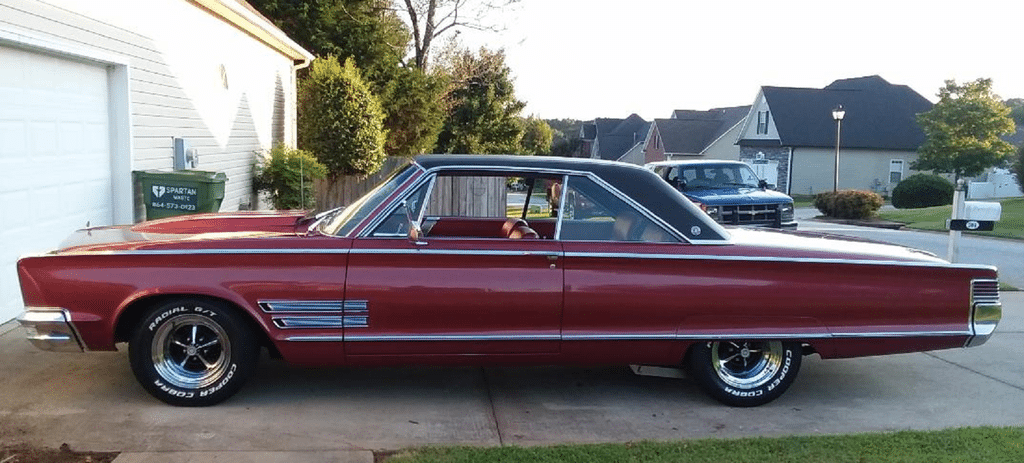

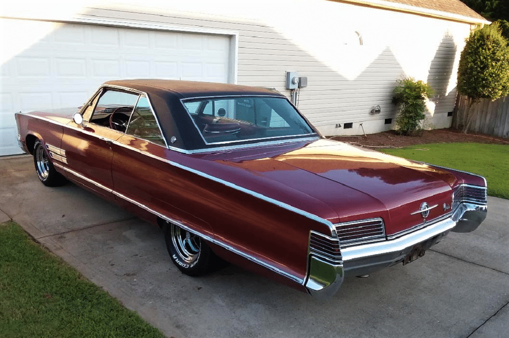

1966 300
245/60-15x8 in front, 295/50 -15x10 back.
Rear leafs moved inbound about an inch to accomodate a 12 inch wide rear tires (otherwise you cant get them out back in a slabbie without some structural modification).

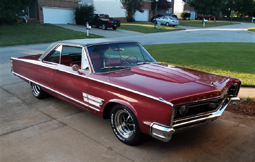

Love your ride. Can i get a side and rear veiw please?
My 65 has 14s and they need to go asap and a little rake would look sweet.
nice '65 boss.
sorry though, thats not my car. member @James Romano owns that beauty. he might have other shots of it here or if you PMed him he might be able to send you something/direct you to someplace its posted.:)
