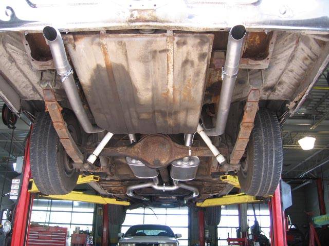

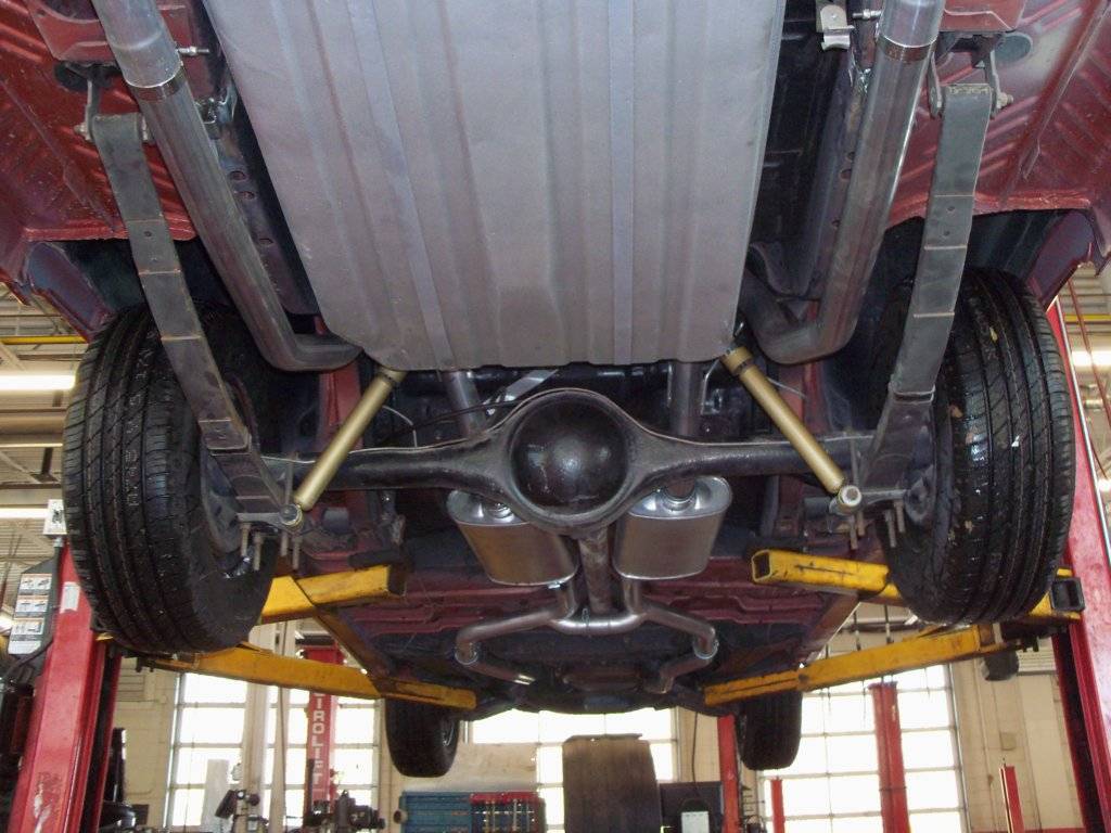

I am on my third TTi system. 3 cars and no problems.
I installed two of them and the fit and finish is top shelf.
As for clearance around the tank,the tailpipes go to the outside of the frame rails.
Just had to tack weld the rear hangers,that's all.

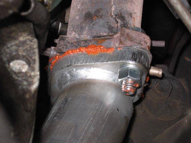

Just give TTi your manifold casting number and the front pipes bolt right on .
The flanges are very thick and never leaked.
Worth the money and sounds great!

If you're going to duals does the .25" matter if it's 2.5"? Duals will be less back pressure no matter what, the larger diameter pipe won't do much (that you will notice) to affect anything that the duals would do with a smaller diameter pipe. The tti kits are easy to install, the 2.5" pipes I put on the Polara this year fell into place almost. A couple light taps with a rubber mallet and I had everything right there where it needed to be. Yes, super thick flanges, and bolts that come with it. I like the 3" system on my other Polara, and I'll put another tti system on my Dart.

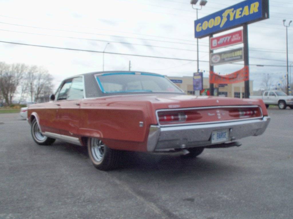

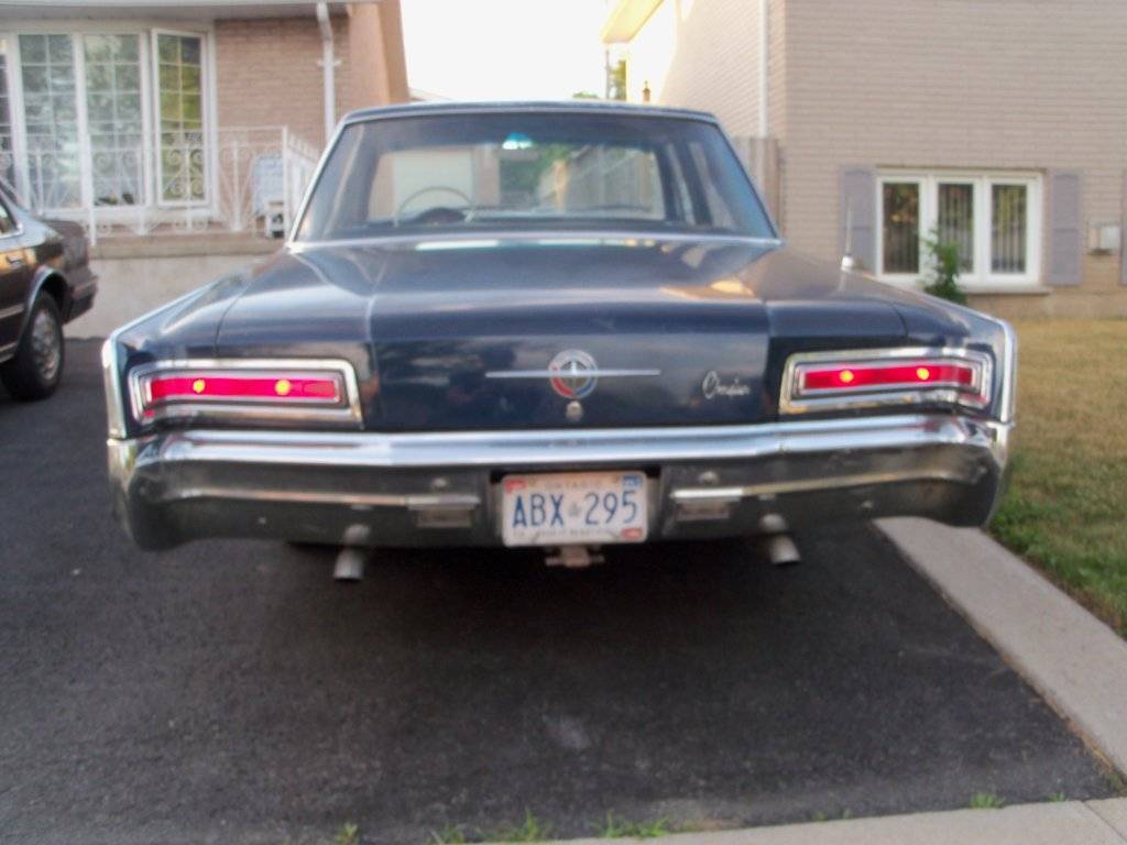

All three use the mufflers that came with the kit Dynomax Super Turbo.
There is no drone on my Newport and the 300 is quiet.
Trick is have the tips extend out past the bumper by 2 inches or so but not out too far.

One advantage of the longer pipes and correct factory ends is that it keeps the rear bumper from getting gunked-up with a coating from the exhaust gases. But I recall that happening on the stock pipes on our '66 Newport. Kind of like the same gray deposits that were in the exhaust pipes, from leaded fuels back then. There's a fine line between being just far enough and too far, though.
