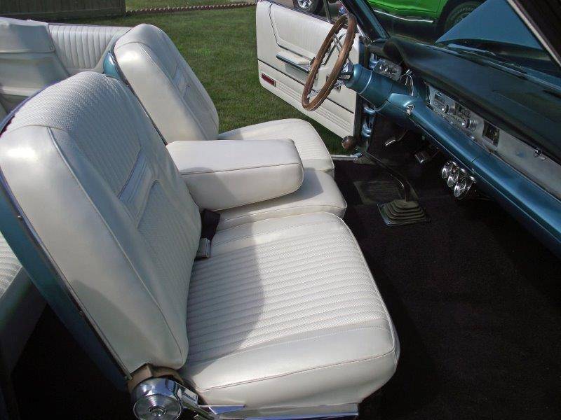

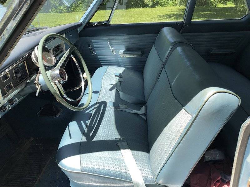

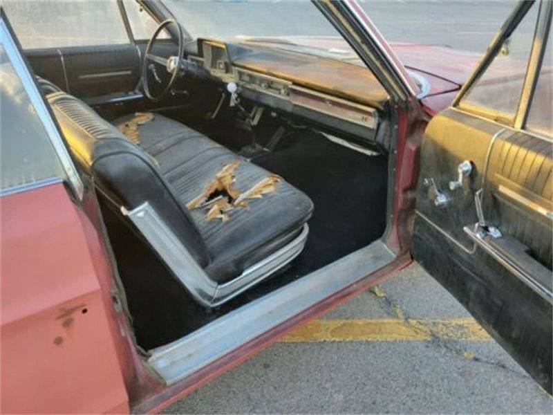

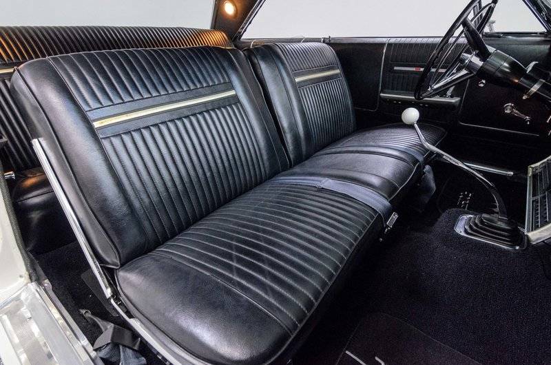

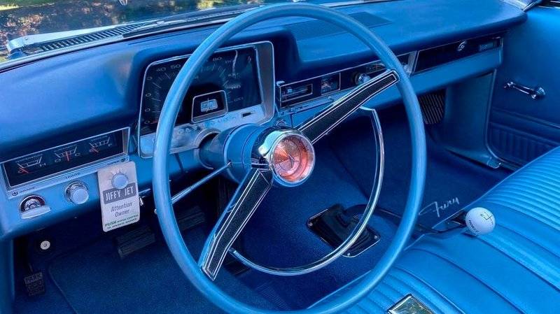

Is there anyone out there who can tell me what shifters in 1965 non console 4-speed cars came with from the factory. I couldn't find anything verified on the internet, but I strongly suspect that the shifter mounted on the following cars is right for the '65 models:
Fury III
Fury III
Belvedere
Fury III cv.
https://www.hemmings.com/listing/1965-plymouth-belvedere-1-882475#&gid=1&pid=1
1965 Plymouth Fury III Convertible | F111 | Las Vegas 2021 | Mecum Auctions
1965 Plymouth Fury
For Sale: 1965 Plymouth Fury III in Cadillac, Michigan
I believe that is correct for a bench-seat C-body 4-speed.
At least all the pics I've seen have such a handle.

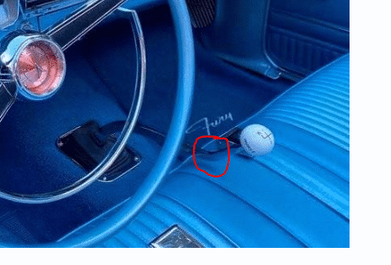

The console shifter arm ends approx where I circled.
When I converted my 66 polara I got a bellhousing, trans, and other bits from Brewers Performance.
They told me that I would have to get a B body shifter and alter the handle to my liking. So I got a b comp plus shifter.
So few days later I'm surfing and I found a place "Shifter Doc" or shift doctor. Specializes in Hurst shifters. Be dammed if they didnt have a proper comp plus C body handle (sold seperatly)
I'm pretty sure there is a picture and or some specs on shifter Doc site.
I wasnt feeling good about cutting and welding a new b body shifter handle. Granted the welding would have been under the shifter boot.
The proper C handle dont hit the seat in 2nd and 4th

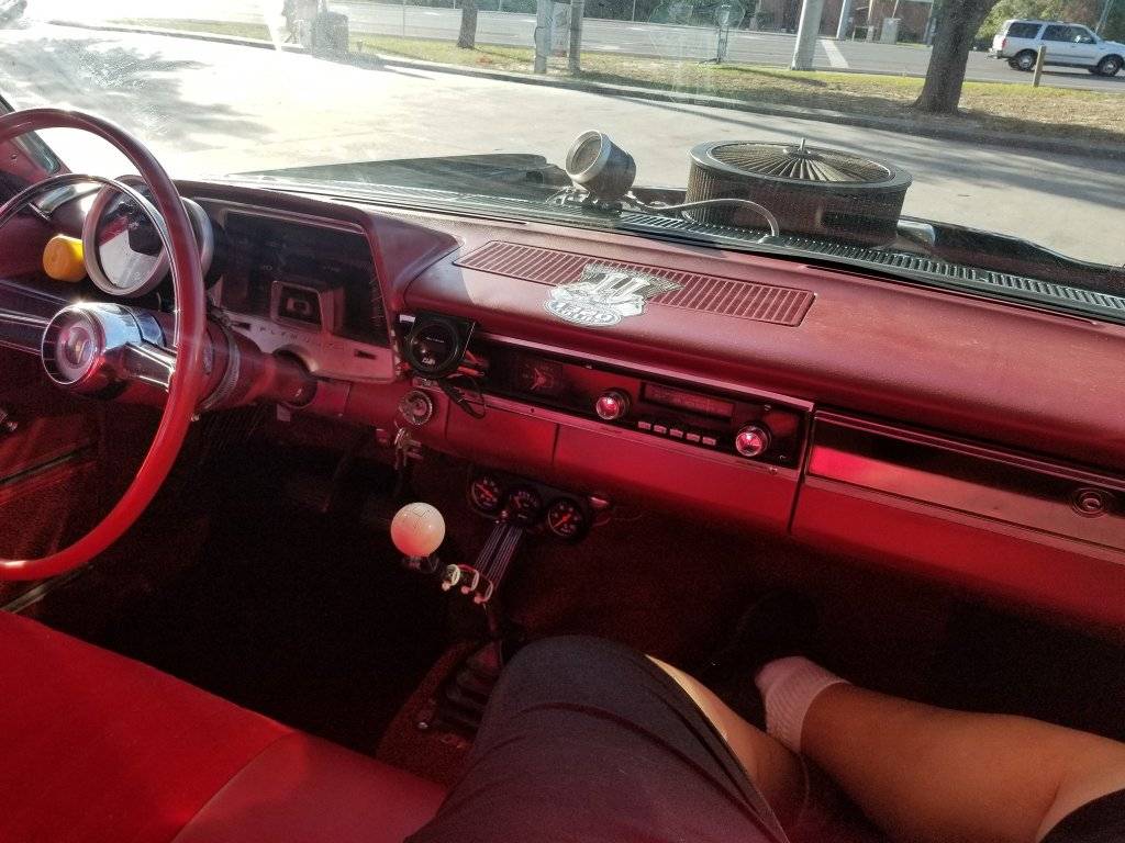

This is the shifter that came in my 65 300...
Is that car all factory? (I' recognize your car, but I don't 'know' it).
Yours is the first buddy-seat 4-speed Slab that I've seen, likely because its a Chrysler - so that may be why it got the console-type handle.
I've seen a bench-seat Newport 4-speed, and several 300Ls - and now a buddy seat.
To me, the console handle would be easier to use, although it likely isn't compatible with a bench seat when shifting out of 2nd and 4th, and yours is the handle I would want with a buddy seat.
Yes, that is all factory. It comes fairly close in 2nd and 4th, but not too bad.
I guess I don't really know where the buddy seat is mounted, for where it's front edge falls compared to a bench seat
Obviously the buckets move, which doesn't matter to the shifter.
When a bench seat moves, it does move WRT the shifter.
Presumably the buddy seat is located such that it is midway, and not as far forward as a bench would go. Which might be why yours has the console shifter handle.
Your car is an interesting data point!
