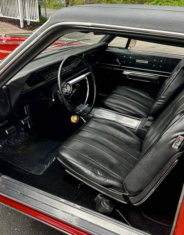

My newly acquired ’68 Sport Fury is a factory 4 speed, and being an early ‘68 still has the Inland shifter. I’d love to change it out for something else. What can I put on there? I’d love to do a pistol grip, but open to other options!

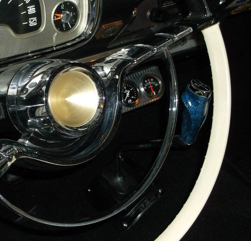

I used to make and sell these a while back. The handle screws on to the shifter arm in place of the ball it came with. The metalflake grips give it a sixties look.
