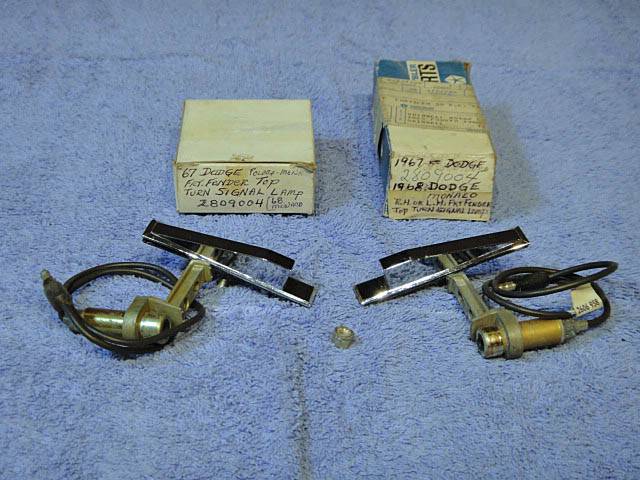

Here's a picture of the assembly, disassembled. At least that's what my Dodge has, I suspect they would be the similar across the brands.
Getting the old bulb out without damaging the amber lens might take some careful finesse, because those parts are held together by corrosion and grime. Soak 'em with your choice of penetrant goop, and make sure you see some clean metal in the socket. And use some dielectric grease during reassembly.
If you do damage the lens, you might find a replacement here: reproductionproducts
