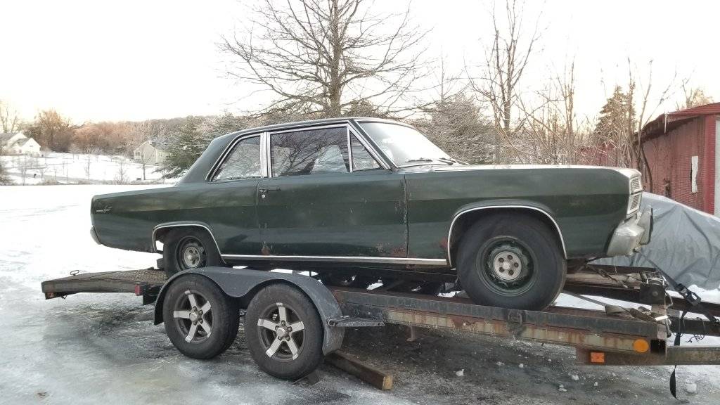

Finally my own '70 Sport Fury GT

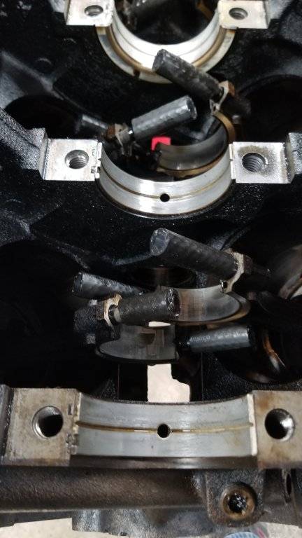

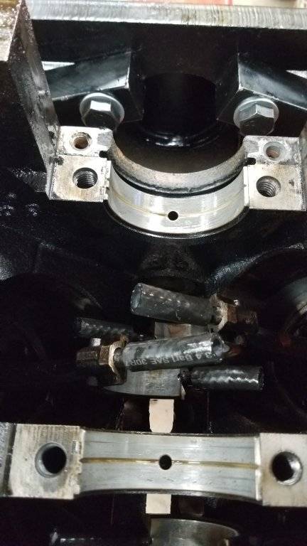

Bearings werent too terrible but had decent amount of grit embedded into them. Crank should polish up nicely.
Number 5 main cap left the factory with a 0.001 undersize bearing. This corresponds with the Maltese cross stamp on the ID pad.

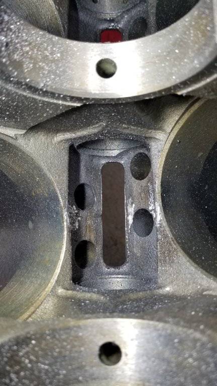

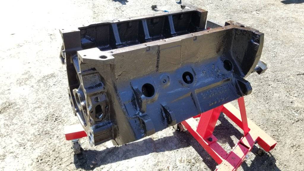

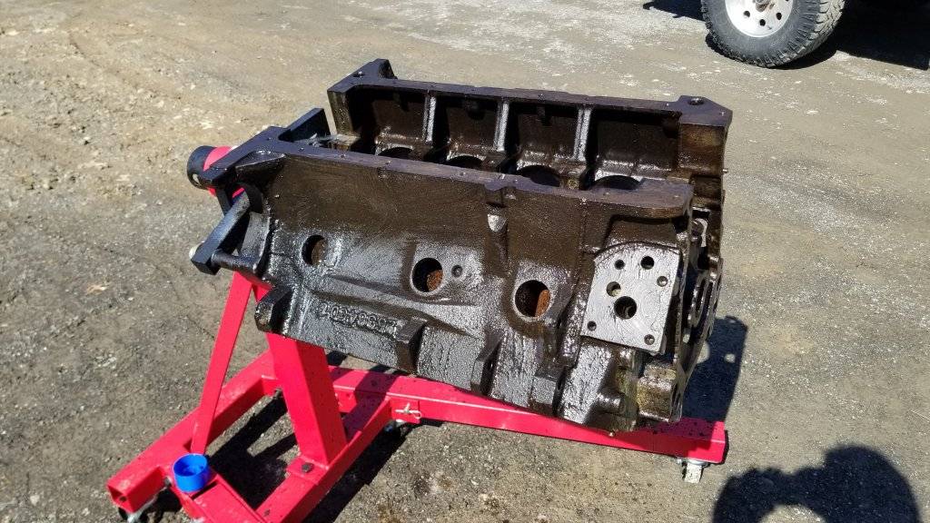

Bite the bullet and decided to pull the pistons out to do a thorough job cleaning the sludge/carbon buildup from the block. Few cans of oven cleaner and a power washer worked wonders.
Cleaned & dried off. Covered the block with WD-40 Gel right after to prevent flash rust.

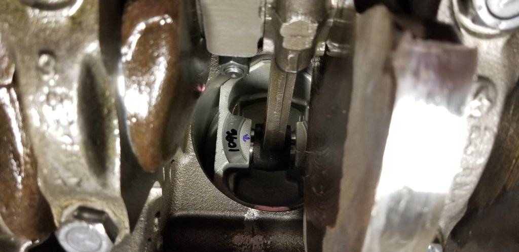

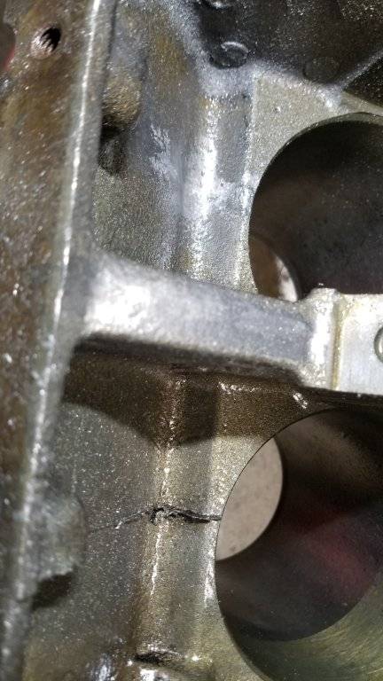

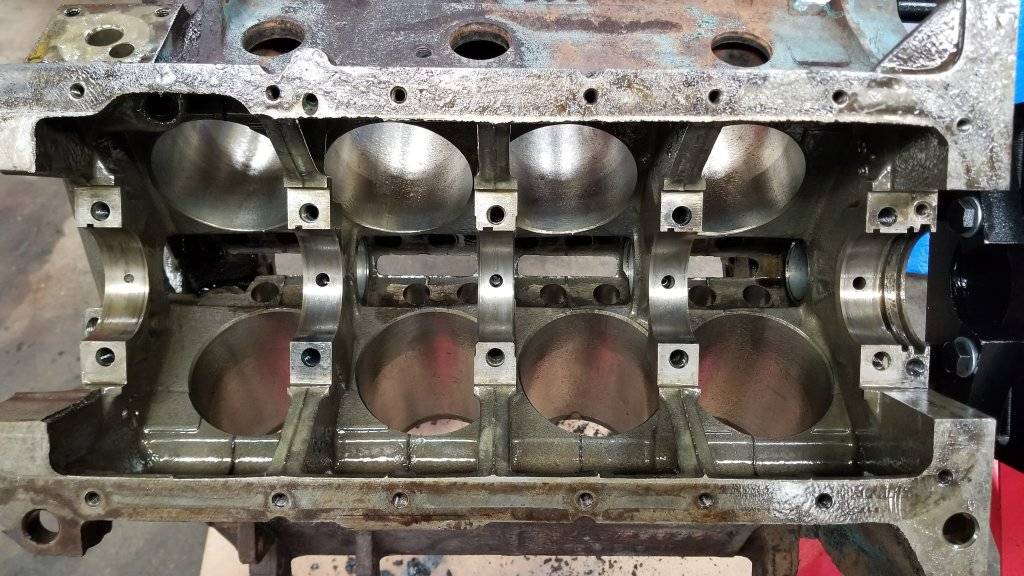

Ran a 3 stone hone through cylinder 1 to see what I have to work with. Pretty big ring shadow. A quick check with some feeler gauges & an old ring showed some pretty significant bore taper. At this point I pretty much made up my mind to send the block to the machine shop for a 30 overbore.
Before it goes to the machine shop I spent a little time with the carbide bur to remove all the excess flashing from the block. The machine shop will give it another thorough cleaning along with the oil galleries.

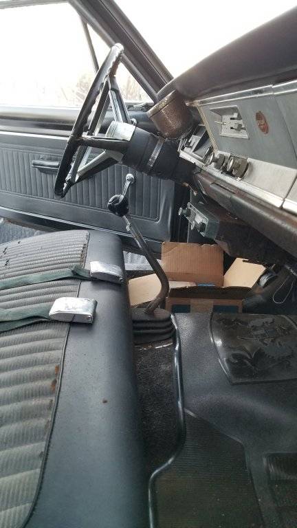

Speaking of rare, I recently scooped up another Plymouth Ive had on my list since forever! 1 of 82ish 4 speed Valiant Signets made for '67. And its an E-code 273 Commando car!
My 1st mopar (& 1st car!) was a '67 Valiant 100 2dr red on red with a /6. Being very partial to the '67-'69 Valiants (and A-bodies in general) I always knew these cars existed but only ever seen a hand full of pictures on the web. When this one popped up and it was for sale I jumped on the opportunity to aquire such a unicorn. And its green like the SFGT!
if a car is that rare you need to pull the trigger when the opportunity comes. keeps you busy :-D

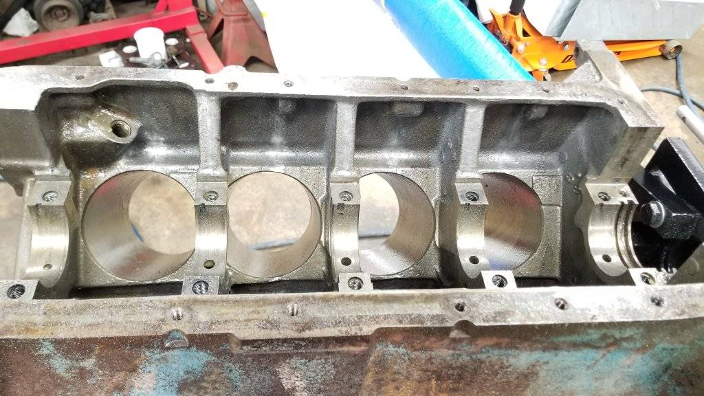

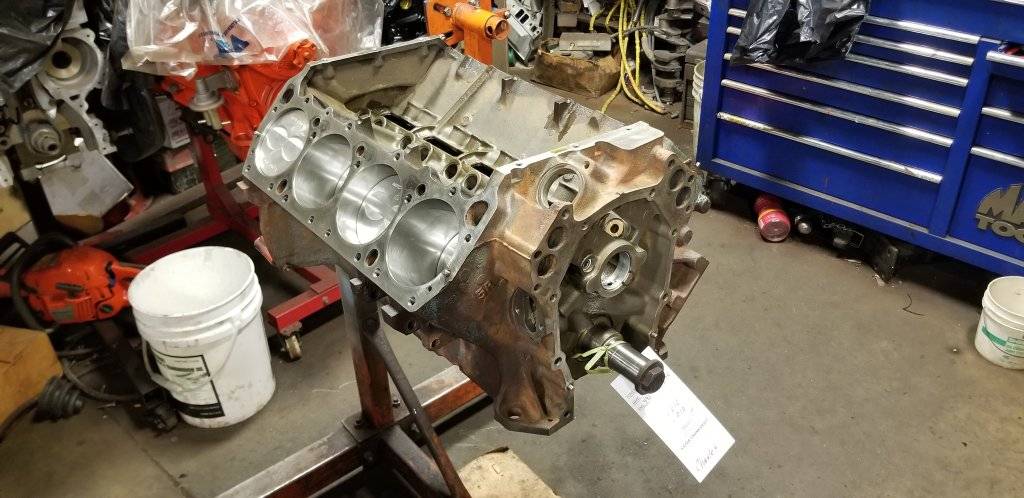

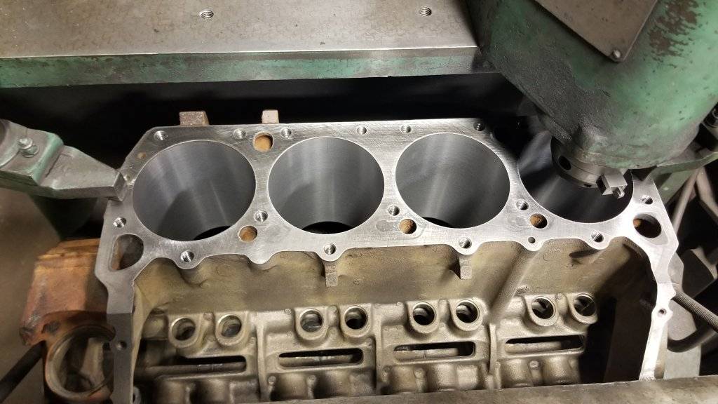

Dropped the GTs 440 off at the machine shop at the beginning of April along with a set of heavy but budget friendly Speed Pro L2355F "six pack" pistons & new cam bearings. Stopped by last weekend and snapped a couple of pictures. They just got done boring it 30 over. Rods have also been shot peened, ARP bolts installed & resized. Hopefully by August Ill have the short block back.

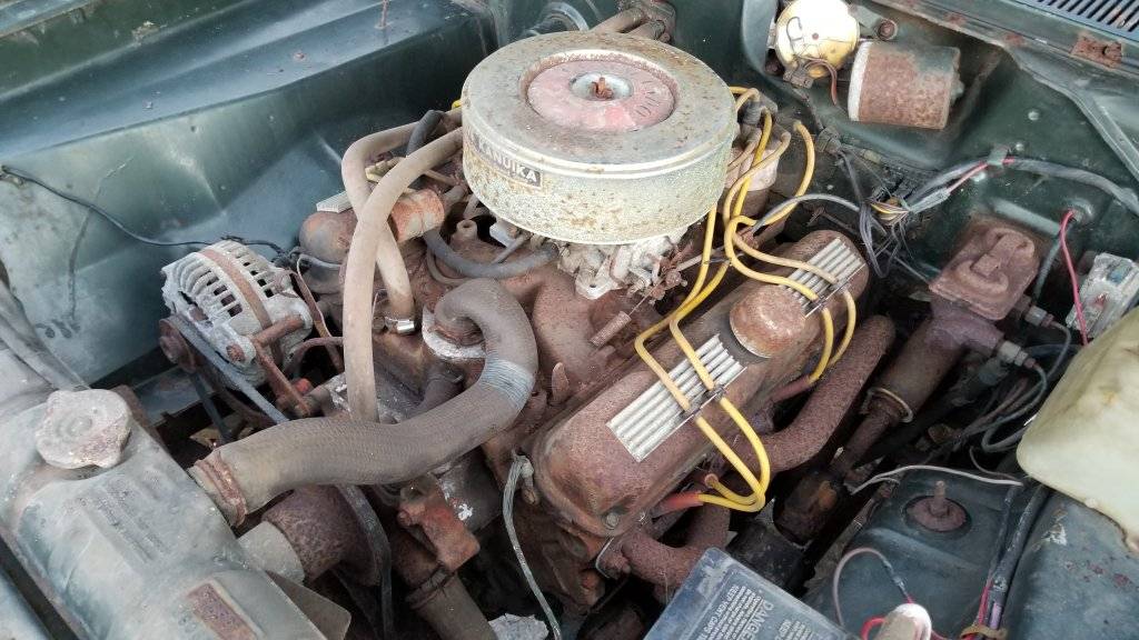

Based on your love for this GT I'm surprised you were driving it around like this.
Rodents makes nests there, and the urine eats at the valley pan.
I've seen at least one engine with hte valley pan rusted thru and nest material and seed shells in the lifter valley.

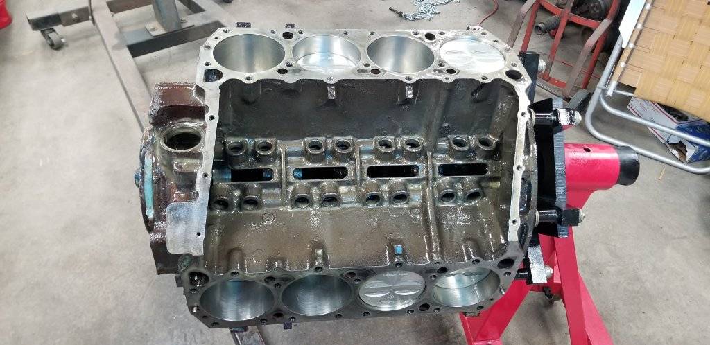

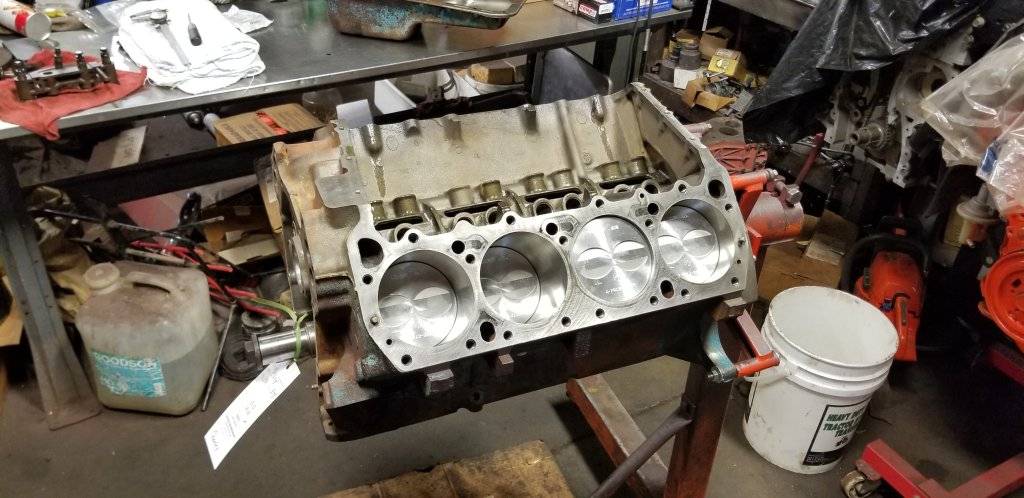

Machine shop finished the short block and I was able to pick it up last week! Bored .030 over, crank was cut .010/.010, rods reconditioned with ARP rod bolts, Speed Pro L2355F forged 6 pack pistons to keep the compression up, and rotating assembly balanced. Have it drowned in wd40 & wrapped up for now as I dont have any time to finish assembling it till at least mid September.

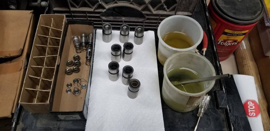

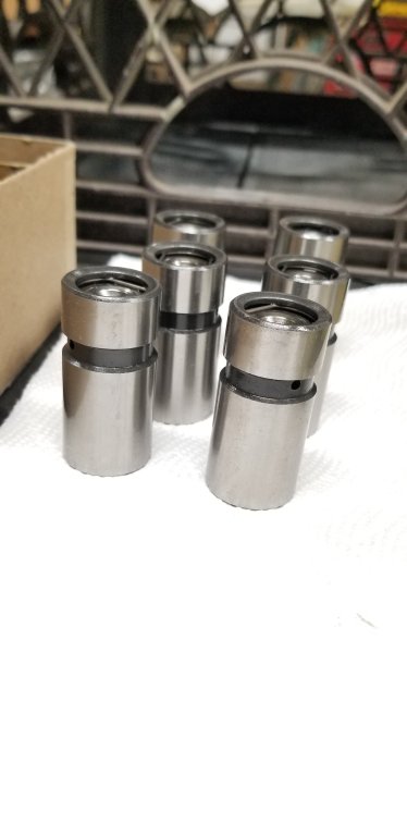

Picked up some 30+ year old NOS Johnson lifters off the B-bodies site. Dont trust the new stuff made theses days... They had some very light surface rust from years of sitting on a shelf so I took them apart and gave them an overnight soak in evaporust which cleaned them up perfectly. Put a coat of light oil to keep the flash rust away.

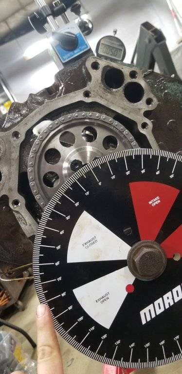

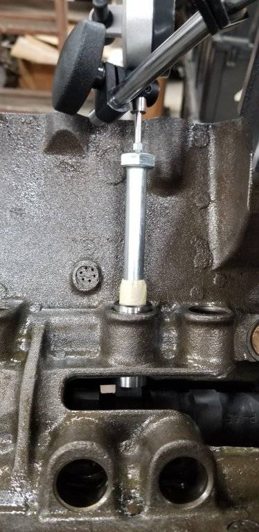

Piston stop set to 0.200 in the hole to find true 0* to set the degree wheel.
Gutted a hydraulic lifter and shoved a bolt in to take measurements. Took a bit of playing with the crank sprocket to get the cam dialed in with a 3* opening & 108* ILC. LSA measured out to 111.5* & lobe lifts were right on the money.
