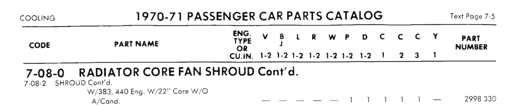

Check the 1970-1971 parts book to see if a shroud was offered and if it was, do a Google search for the part number.

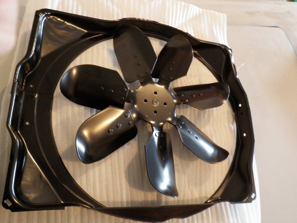

need a shroud or fan just draws from the side....seen the effects first hand when building my 91 gmc...shrouds make a hugeeeee difference in actually drawing air through rad
I've never seen a 22" shroud, so it's either swap out the rad frame for 26" or go the bike tire/fibre glass route. Neither solution appeals to me.
I had a 66 Fury with the 22" radiator.
A 26" radiator bolted right onto the existing radiator frame.
Bill, what cars used a 22" shroud. I should definitely find one.
My 65 does.

I just did some parts list digging and discovered ..
so they do exist but I don't every remember seeing one. I wonder where they were sold, maybe hot places where AC wasn't popular. Possibly fleet vehicles where the purchaser was too frugal for AC unless it was an executive ride.
Graham, what does your search computer say about 2998 330 ?
repro shrouds are made for a, b and e bodies. check ebay. maybe they can be made to work.
the trick is finding the brackets.
