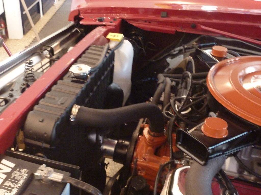

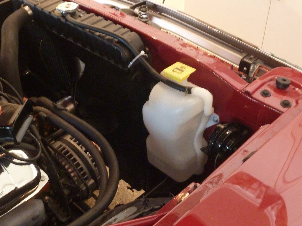

For the first 90,000 miles of it's life it was happy in the cold and the heat. No AC, 7 blade fan, 22" rad, no shroud and no overflow bottle because it never over heated. The block was boiled, the heads were boiled and the rad was rebuilt with an OEM core. The water pump, thermostat and rad cap are all new. It should be it's old self, but it's not.
Last night I was driving here and there in 30+ C ( about 86F ) and the temp slowly rose to about 230F and steam started to fill the engine compartment. Steam was coming out around the cowl was being sucked up by air vents and coming out of the defroster vents. I assume the steam was coming out the rad cap release. It was exciting!
Back when Cancritter (Derek) unveiled his '71 GT, Dobalovr (Many thanks
Graham) gave me an overflow bottle (application unknown) so today I decided it was time to see if it would fit. It's perfect. Tomorrow I'll do another slow cruise and see what my temp does with a "full" rad.

View attachment 132152 View attachment 132153

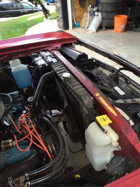

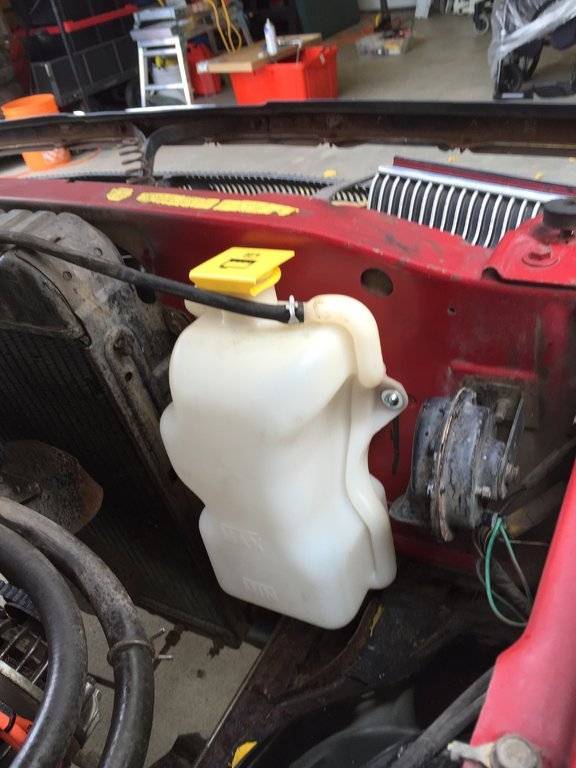

Can't help you on the thermocure, but that bottle fits in there nicely. It didn't on my wagon due to all the A/C stuff in the way. That bottle is from a mid 80's 1/2 ton, BTW. It's what I put in my 300 10 years ago.

Gonna watch this thread. . . I'm also gonna ad an overflow bottle. . .
