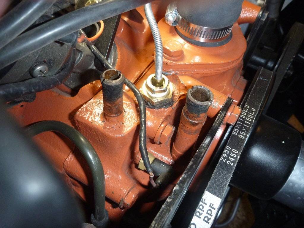

Well 4 weeks later I'm still playing with this stupid heater! Before I do anything with shrouds etc. I need to either fix the leaking heater core or bypass it. The thought of pulling the old core out, but finding a replacement and getting it all back together strikes me as just too much work for a heater I'll probably never use. So I've decided to bypass the heater completely.
My first idea, pull the heater hoses from the water pump housing and jumper with a short length of hose. Ok so the silly hoses are a different size, 5/8" ID and 1/2" ID. So remove the nipples and insert plugs, which by the way is how Ma Mopar did it on heater delete cars. Anyhow I pulled the hoses and looked at the nipples.

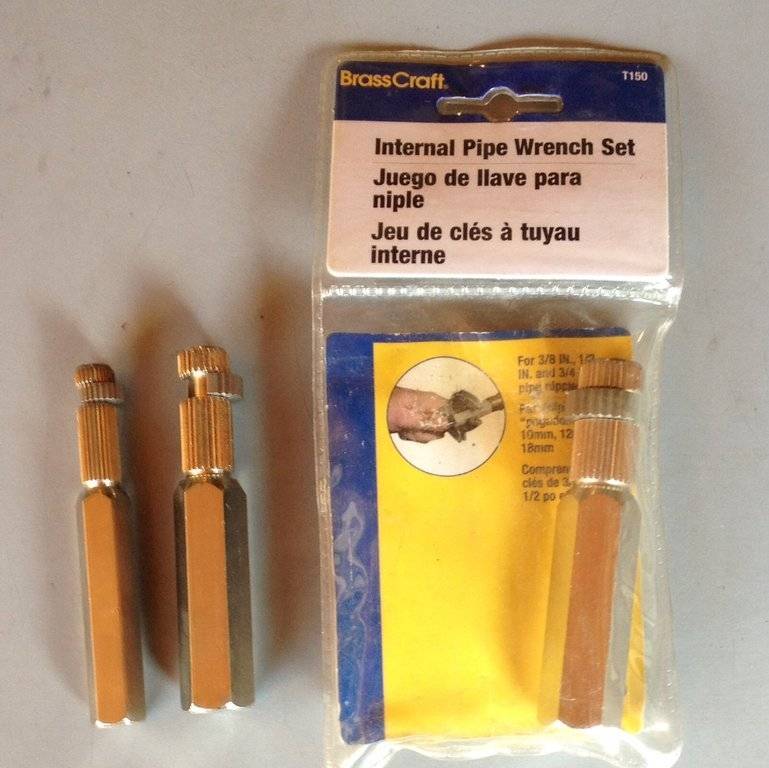

Let me tell you, those babies are really tight, like welded tight. I tried a big washer and a crescent wrench, bent the washer. I tried penetrating oil and channel locks, wouldn't didn't budge. Did some Google research and found the plumber dudes use an Interior Pipe Wrench. So more searching found them at Home Depot.
Heck of a theory, but not quite. They are designed to fit inside 3/4", 1/2" or 3/8" pipe, but the nipples are 5/8" and 1/2" OD not ID. The small one, 3/8" ID pipe, fits into the 5/8" nipple, but not tight enough. I could get it to lock, but after putting as much load as I could get with a 1/2" drive ratchet without any nipple movement, I decided to quit before I broke something. However, before giving up I used a big pair of vice grips and a hammer also with zero success. I figure those nipples are rust welded. Any further down this rabbit hole and Ièll screw up the nipples and will have pull the who housing off the engine.
So now I'm looking a 5/8" 180 deg bypass hose connected to the 5/8" hose with a 5/8" to 5/8" connector and using a 5/8" to 1/2" connector for the other side. For anyone waning to do it this way, the NAPA part numbers are:
UNR 9904 - 5/8" to 5/8" connector
UNR 9910 - 5/8" to 1/2" adapter
UNR 10700 - 5/8" molded hose 180 deg bend
I think I'll insert the loop just past where the heater hoses are clipped to the wheel well.

Yup tried pulling those nipples off a 360 intake ....FORGET IT!
Looped hose is the answer Im afraid. I'm going to Idaho next month if you need anything from Paul...
I feel your pain. When I replaced the water pump on my 500, I wanted to reuse the nipples in the old one. Not a chance in hell that they would come out for me, even out of the car.

I've seen some guys really heat up the area around the pipes with a torch and also apply a lot of PB Blaster. This usually works. . .
I sawed the nipples off flush and then used a screw extractor.
It was a do or die moment.
If the screw extractor didn't work, I was f****d.
That's pretty gutsy! All I can envision happening to me if I tried that is a broken extractor and having the mess permanently sealed with brazing rod.:wideyed:
A couple days of penetrant, heat, turning the extractor one millionth of an inch at a time, and going to church.
