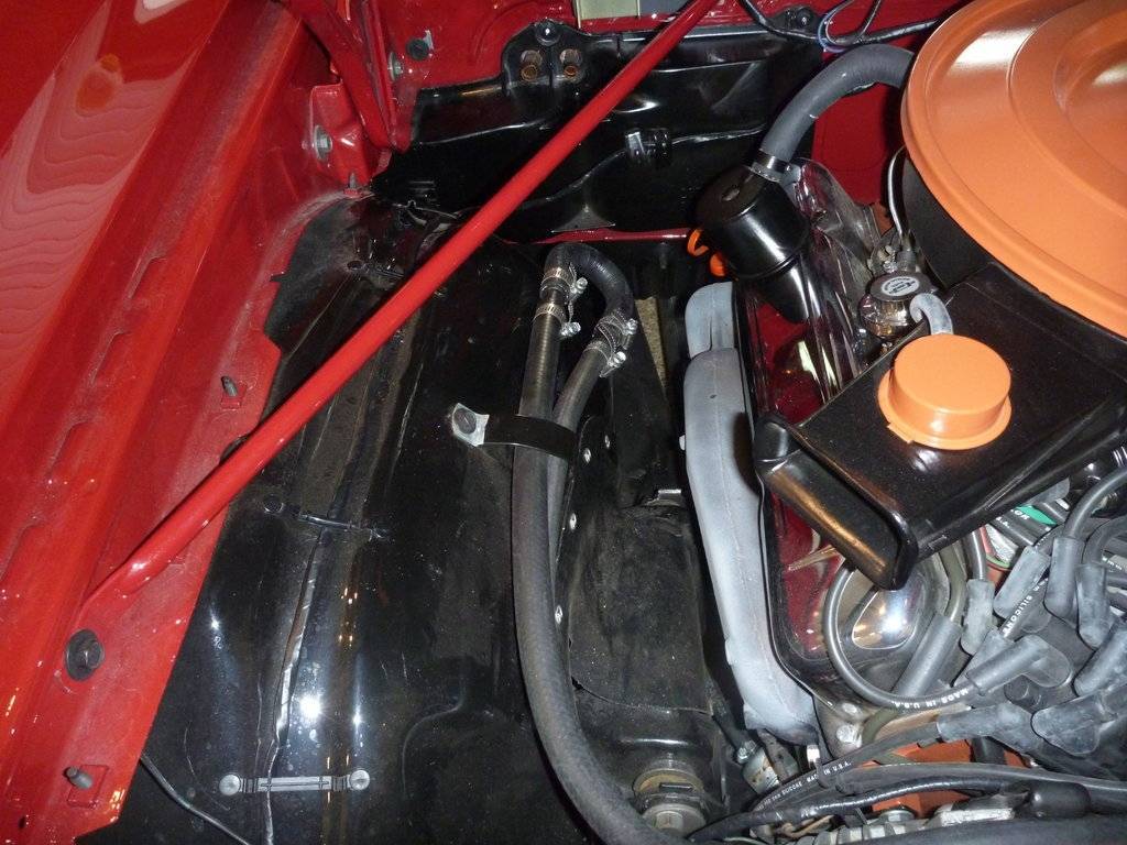

Well the bypass is installed and doesn't seem to leak. I might shorten the lines a bit to get the loop back closer to the fender tie down. As it is I can see it sagging down towards he manifold.

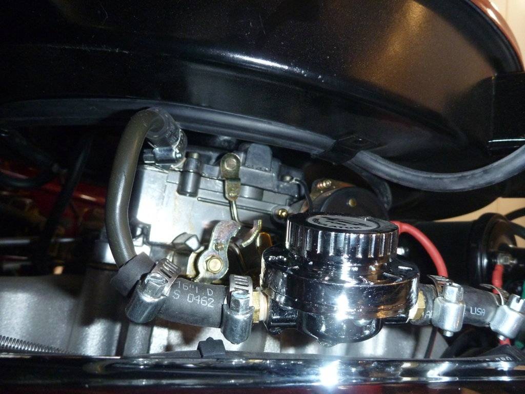

I let it idle while I watched for leaks and noticed a fuel smell. Well the fuel pressure regulator is dripping. It wasn't doing this last year. This crazy stuff continues and I'm going to start calling her Christine!

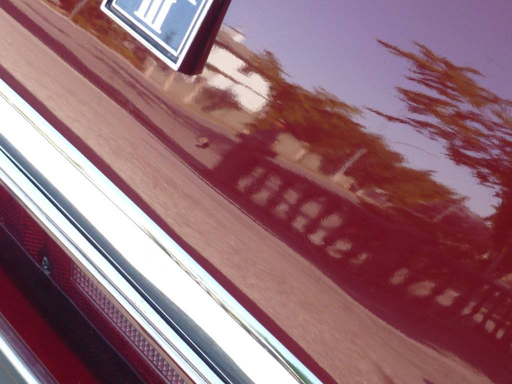

While I'm pondering this new development, Tobias drops in for a visit and we raided the beer frig and talked cars. As for the fuel leak, I'm going to remove the regulator and replace it with a piece of fuel line. If the engine is happy then enough done, if not I'll get a new regulator, possibly one with a gauge purely for sex appeal. Meanwhile Tobias is checking out my paint job and discovers a tiny paint bubble on the trunk. Crap!

Everything else is poop happens,the paint bubble after all I seen of Paul's work is a true disappointment... but IDK how you would avoid it. From all the great step by step photo's in Critter's restoration, I don't see what else Paul could do to help prevent this... maybe it's a sign to enjoy her more.
I must point out that the bubble is not Paul, it's the guys that did the bodywork 17 years ago. Paul made everything straight and smooth. He then shot the most amazing paint job, then color sanded and buffed.
I can't even get too excited about the bodywork that was completed to epoxy primer then parked in a farmers field to get cooked in the sun, frozen in the winter. Then it suffered another 13 years in an unheated garage. Back in the day, brand new cars started to show rust bubbles sometimes in the first yea\r or so.

Was talking to Paul and kidding him about my trials and tribulations with the heater and fuel leak. He wants me to find a new heater core and he'll install it next month when he ventures north for another visit. The paint bubble isn't Paul's fault, most of the body work was done and sealed under epoxy primer when I delivered the car to Paul. The bodywork was pushing 15 years old and appeared to be rust free. Paul's block sanding did find a couple spots on one of the rear quarters which he stripped and made right. The trunk lid, however, didn't show any spots or pin holes. Paul will probably fix the bubble at the same time he fixes my paint chip. My paint chip happened when the Park pin didn't seat properly and the car rolled away and hit a concrete fence post.
