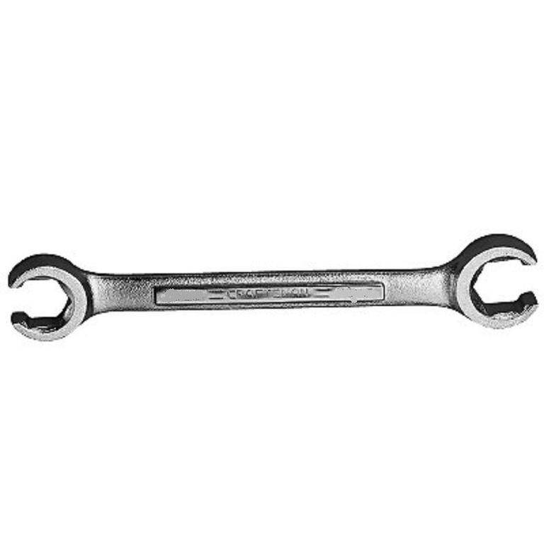

Use a flare nut wrench.
Yes, 3/8"
You need a better flare nut wrench than Crapsman ever produced... I would give those away if I still had them.
