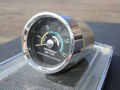

The modern equivalent to this?
Or this?

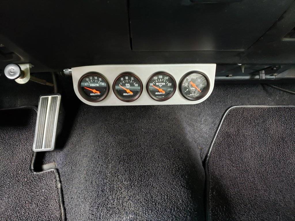

I added one in my Fury for kicks.
