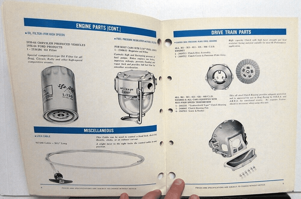

On my 66 NY 440 4V it has a unit between the fuel pump and the carb it reads chrysler corp fuel pressure regulator but dont see anyway to adjust also the unit has a glass sediment bowl on the bottom do i need that?
I'd like to take the thing off and get full flow to carbDealer installed accessory. No, you don't need it.
Here's one on eBay. Mopar NOS 1937-69 Ply Dodge DeSoto Chry Mileage Saver Pressure Regulator 2240633 | eBay
And from a catalog. Not my pic.
What carb are you running and have you tested the fuel pressure? Carter/Edelbrock carbs don't like more that 5# and Holley's more than about 7#.I'd like to take the thing off and get full flow to carb
