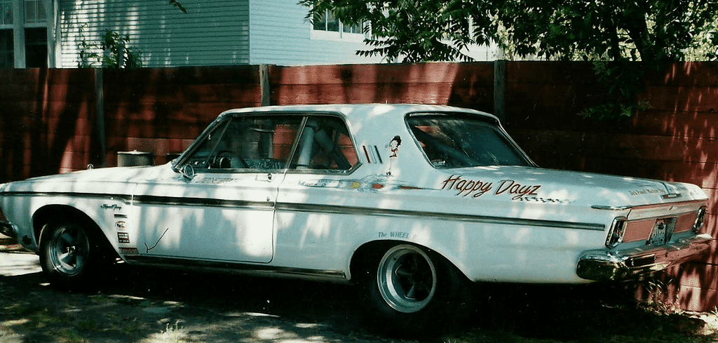

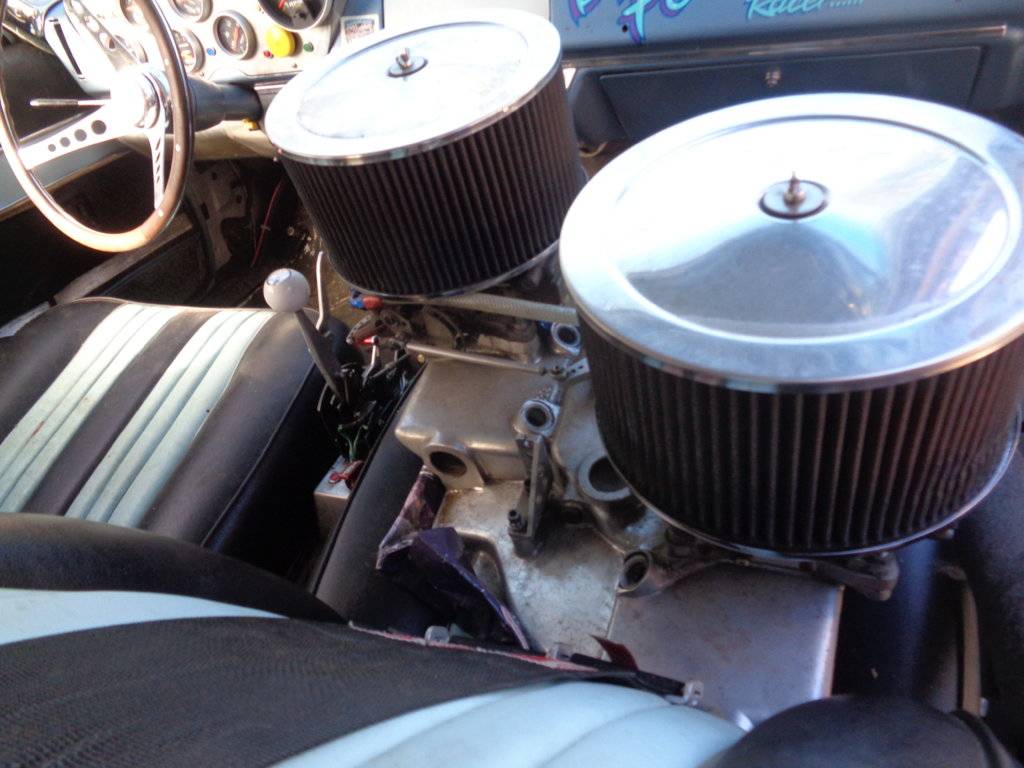

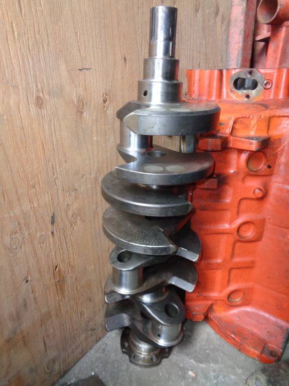

    i ran 3200 rpm converter , 4.56's in my 63 fury , with a 30'' cheater tires , 6200 through the traps , through the mufflers . still working on its new engine . rb block 4.40 - 4.5 bore , 4.5 stroker crank = 547 - 572 . max wedge setup , but vi'll leaning towards my mech hilborn setup in have . this was intake i had been running , the new motor would get the newer max wedge intake , match ported with my (chapman ) mopar stage 6's . man i miss driving that car around , drove everywere . bob your a lucky son of a gun . how those 3.54's do it for you . that the gear i run in orangey . DSC00898.JPG
