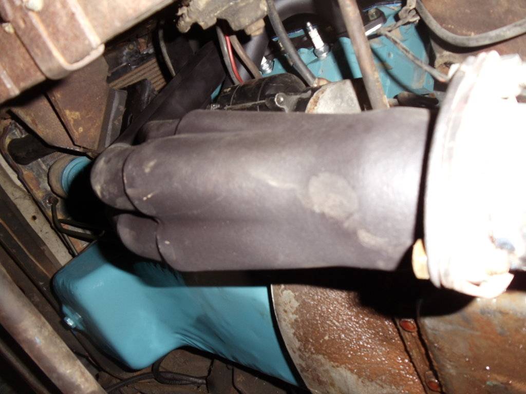

heat shield ! man its so close to the freeze plug the connection nut is in the hollow of it , you need to pull the cable connection any from it . sorry no good pics . and i put all my ride ground cable to the starter mount . its a best place for it . all also run a large cable back to the starter relay . oh and yes my battery cables are 0/1 welding cable for ground on an arc welder .

heat shield ! man its so close to the freeze plug the connection nut is in the hollow of it , you need to pull the cable connection any from it . sorry no good pics . and i put all my ride ground cable to the starter mount . its a best place for it . all also run a large cable back to the starter relay . oh and yes my battery cables are 0/1 welding cable for ground on an arc welder . View attachment 315690 View attachment 315682 View attachment 315683
