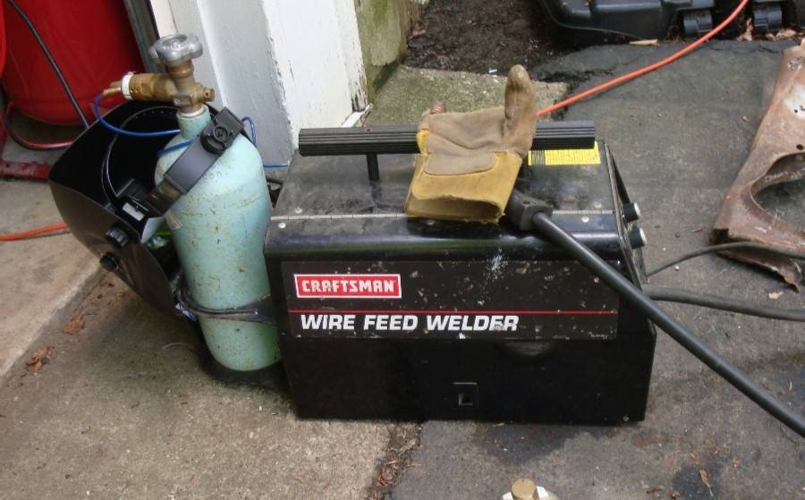

I don't know the exact capacity, it is small, here is a picture of it.
Ohhhh, well then. You should be able to get a 40 for under $200 filled the first go 'round.
*Edit* NM that's a 20. 20 bucks to fill it. If that.
*edit 2* where's the regulator?
LOL, I didn't buy one. There is a little button that pops out, and when I stop hearing the hiss after I pull the trigger, it's time to fill 'er up again.
