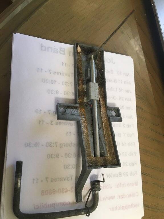

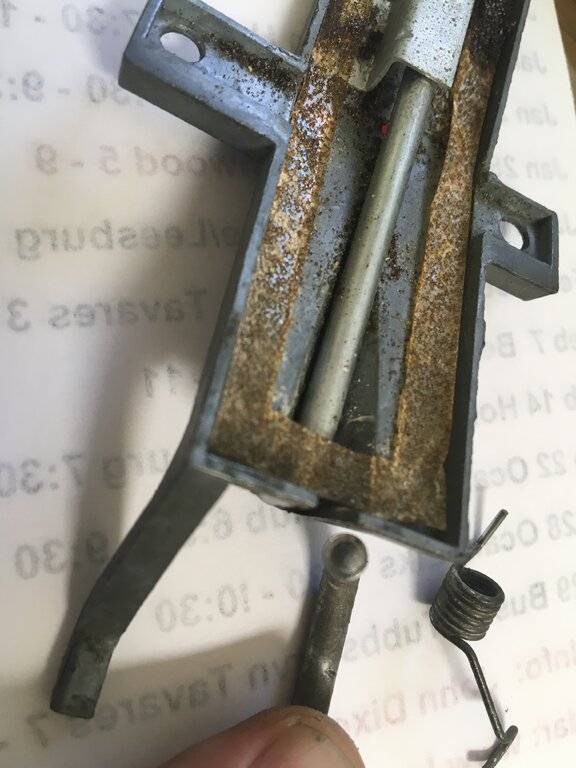

Yes, Ross. Thanks. As it turned out I didn't knock it off the rod broke. I now have to investigate whether it is machined smaller where it goes into the assembly or if it is a pin I can try to remove/replace. Thanks,

Thanks for the confidence. I did fashion up a new rod but apprehensive as to how I will keep the needle affixed to the shaft. We'll see. I'll, no doubt, shop for a replacement.
Just remember, there is no load on it, unless other issues exist with the needle...
