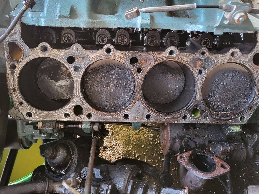

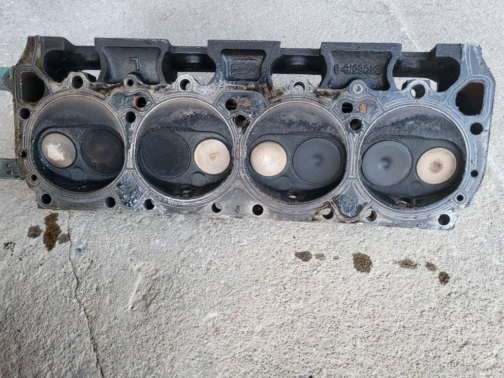

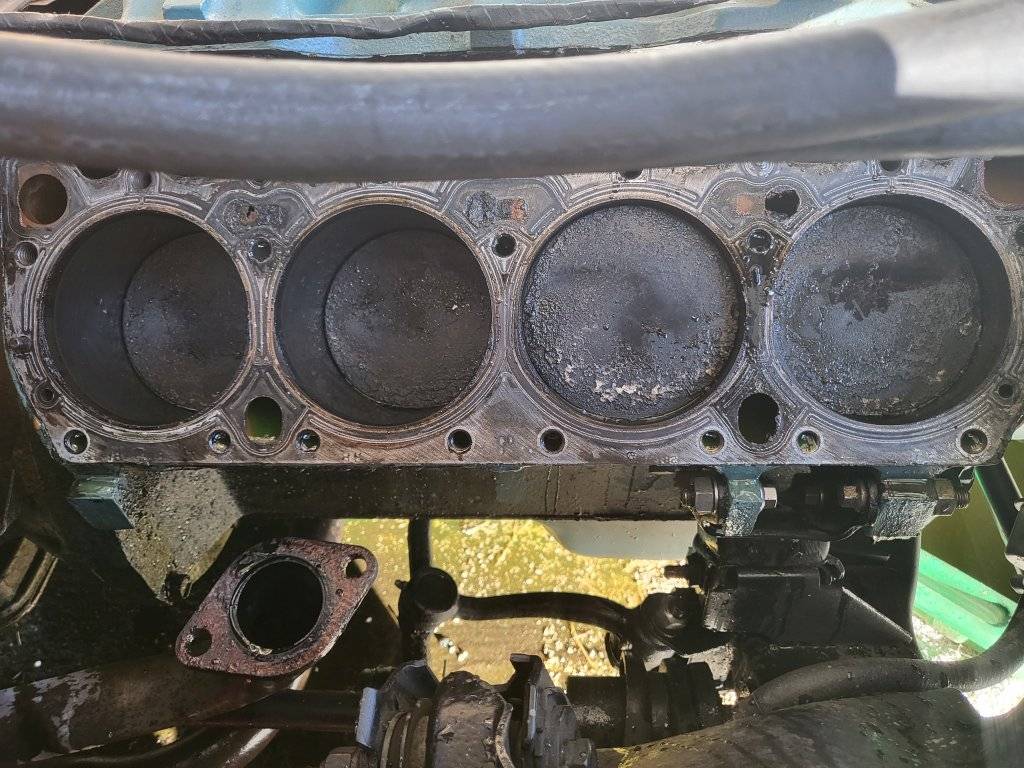

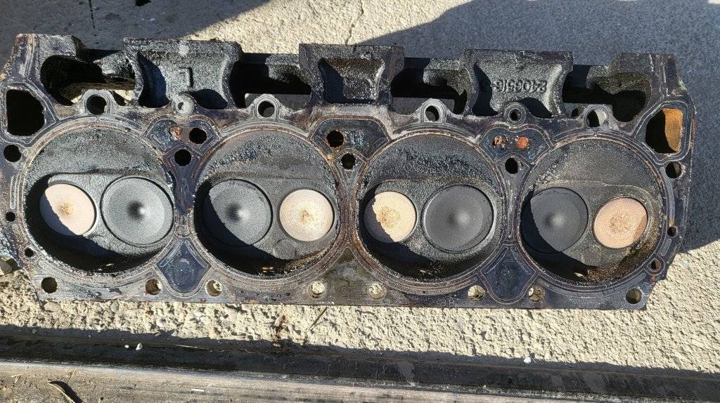

Goldie will get her orginal heads reconditioned.
Hi Rip,
516 is closed chamber 73.5 cc. 1970 383 originally had open chamber 906 heads 88 cc.
I was also thinking about compression and wondering whether the transition to closed chamber would cause knock.
It's not my engine. I was talking to another guy. His 1970 383 has run fine with 516 heads for the first 5 or 6 runs with the car, but it didn't sound like he has tried wide open throttle. Also, with the smaller exhaust valves, I'm not sure whether that makes the problem worse with less cylinder evacuation at WOT.
Felpro head gasket may have added cc over the factory steel head gaskets, so that might have helped. I didn't ask what head gasket he used. Sounded like he had put the heads on without rebuilding them. Ben
never seen a 915 or 516 heads that were 73 cc unless a lot of milling. they were 79-80 cc. the 1.60 will not hurt anything other than power in the upper rpms plus the 1.6 helps your torque in the lower rpms
I agree on the cc's having measured myself.

let's back up to post 1 and post 38. post 1 is going to keep the 516 heads I would say why not for what you're doing for a nice driver. do a good valve job, check spring pressure maybe add a shim to get back some spring pressure or new springs, check for straightness and check guides. new exhaust seats maybe if they do them right but if not just add a lead additive every so often. if the exhaust valves are bad you could go with 1.74 valves if you want the cost would be the same. post 38 I say the 1.60 valve would support a 383 and even a 440 if you're not going over 5200 rpms. zymurgy can you measure how far the pistons are in the hole 2 barrels could be .070 in the hole.

Sorry I am not arguing just trying to learn by going back and forth and expressing my opinion and what worked for me over the years. I already learned a lot about the site you posted up moparts.com thanks, plus everyone thinking that the 516-915 heads were 73 cc because it was passed down over the years.
Yes, I have had 1 set of 516's near that and they were heavily milled. Another set was milled some and still only 78cc
