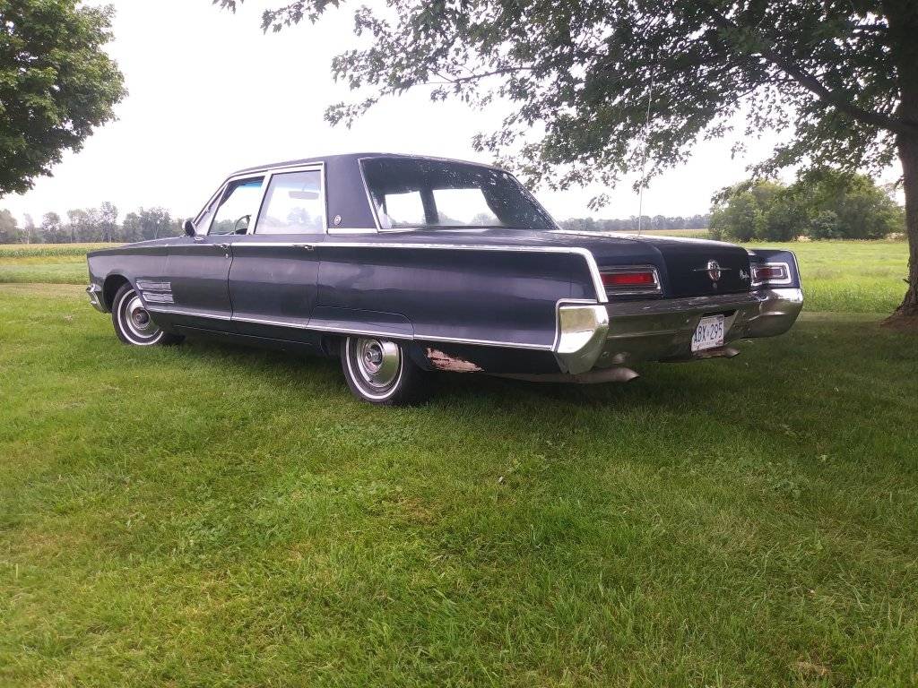

Gonna get dual exhaust on my 66 windsor...
