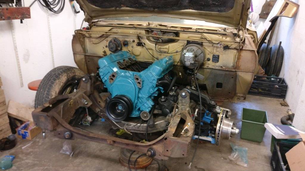

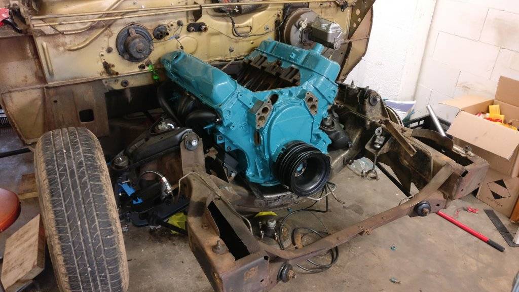

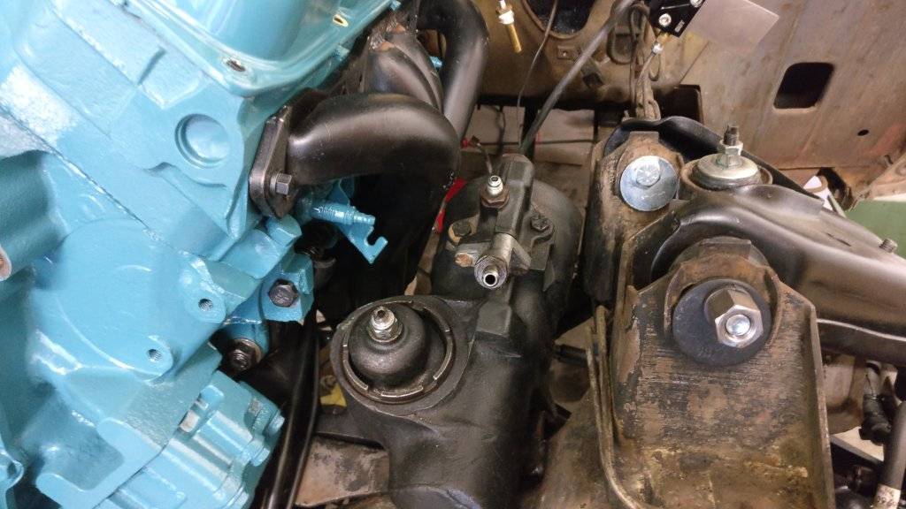

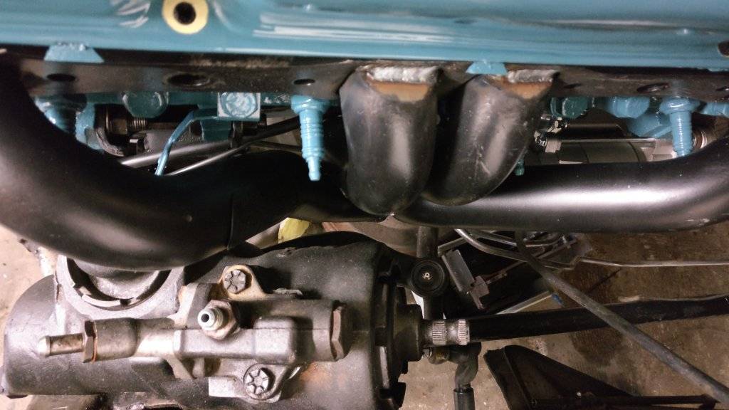

I've used hedman 78070 for my mopar 400BB.
Works great with my '68 Newport. It can get tight to the booster and steering gear when using an RB tall deck engine. No experience with those...
For more info check out my Newport build
