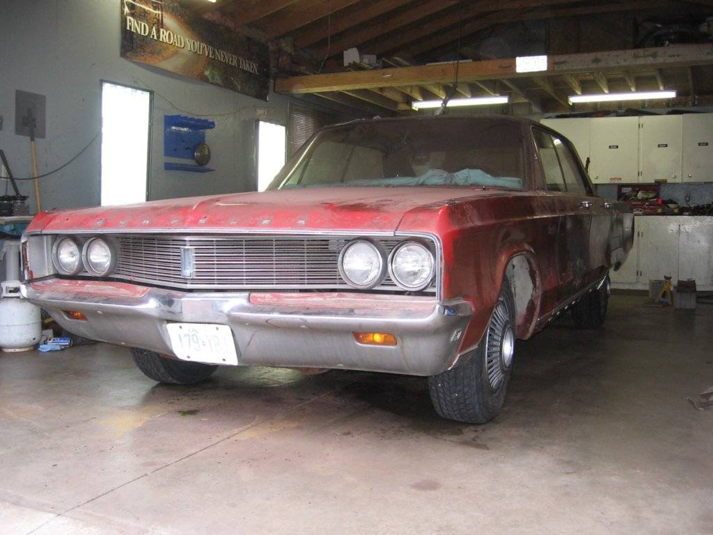

Shown here is before and after resto pics.
The flat surface of the Hella's are not that noticable and looks stock.

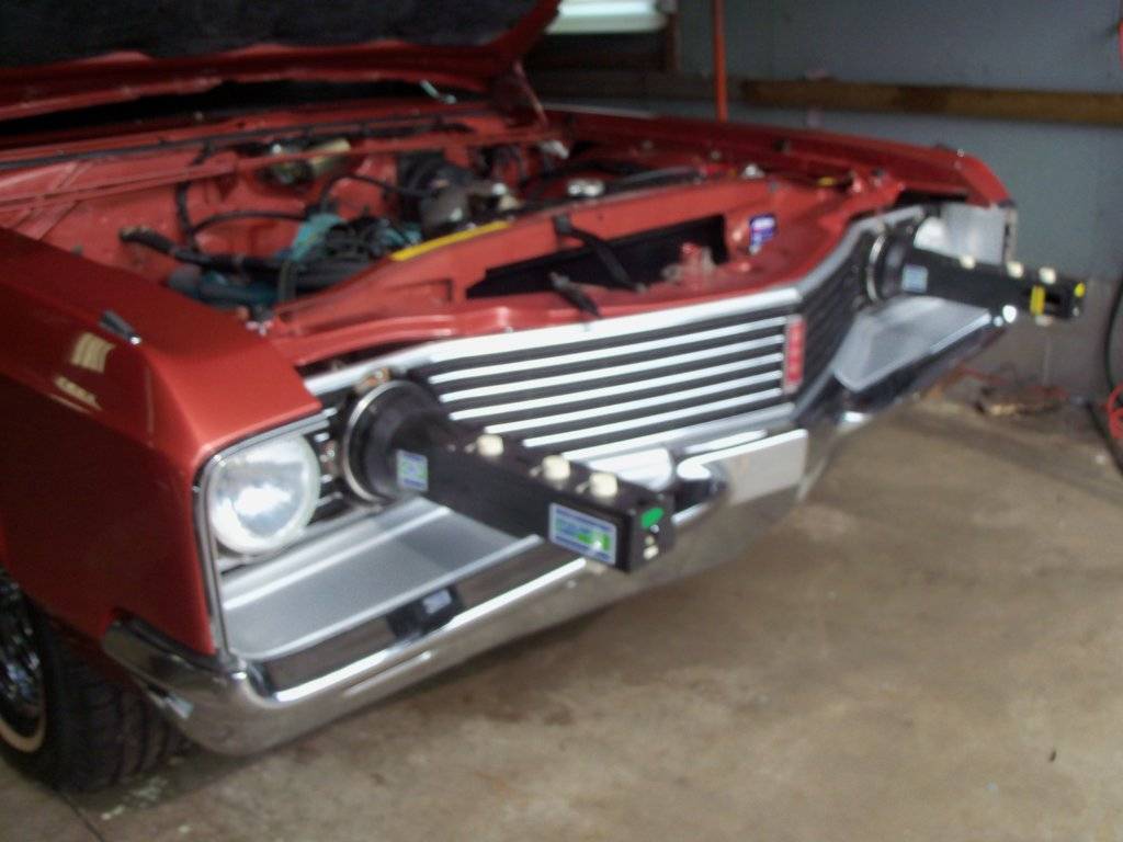

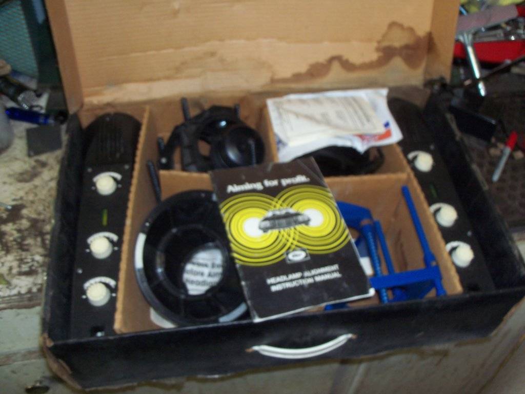

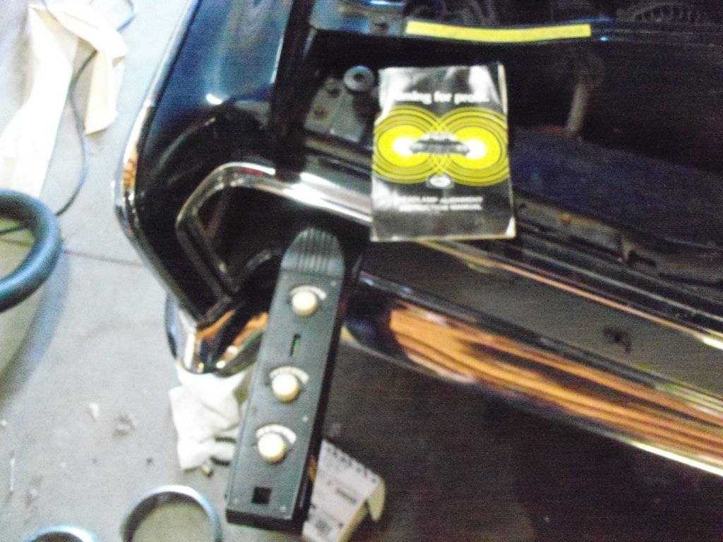

Very important aiming is.
I have an old school aiming kit.....

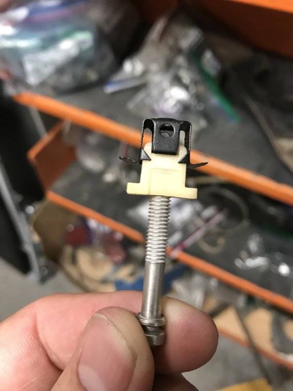

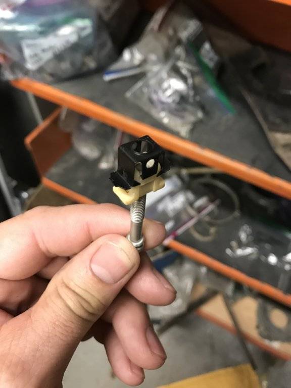

But... it appears the little plastic amount for the left/right aiming screw won’t stay in metal panel behind the light. The plastic mount appears to be in really good shape, wondering if there is supposed to be some type of tab on the panel that might be missing?
There are these little black spring clips on mine that snap into the hole and trap the plastic piece.
Those are way better pics than what I could take. Thank you!
So mine have those same metal clips, but it doesn’t seem to stay in the hole. Both the plastic and the metal clip come out of the hole...
