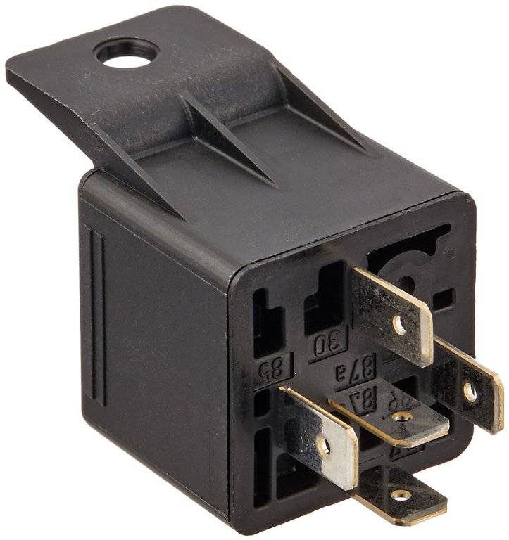

Or you can look at post #3 in this thread and you'll see a real simple wring diagram using an inexpensive and easily available Tyco relay. I used the existing wiring colors for that diagram, figuring that most were concerned with adapting this to the original wiring. Here's how it breaks down using the numbered terminal connections on the relay
#85 goes to the switch.
#86 goes to ground
#30 goes to a circuit breaker (20 amp would work fine) and then to power.
#87 goes to the "open" motor terminal
#87A goes to the "close" motor terminal

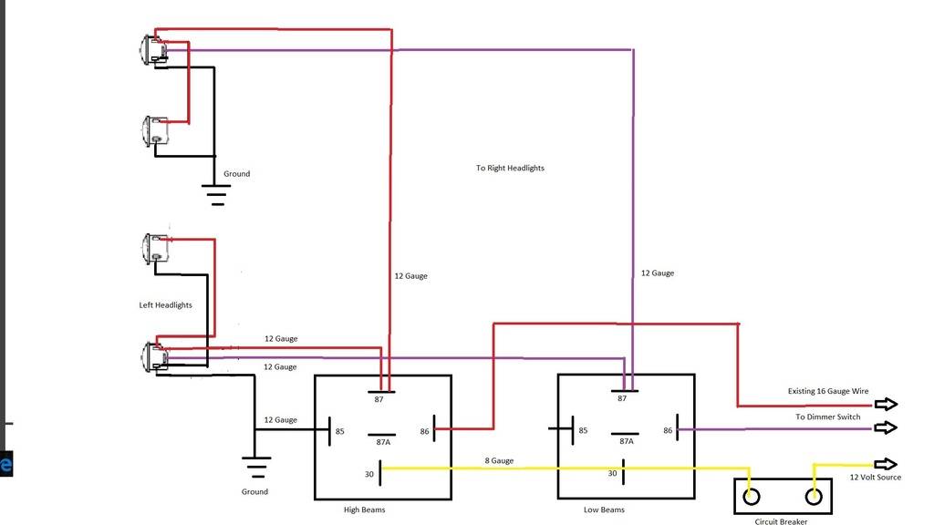

Hi John,
Great post. A while back i had an issue with the Putco harness I bought. Couldnt get it to work with the headlamp doors i have on my '69 300 convertible even with the fix that someone had posted i had issues so... on to this post. I ordered all of the items you have listed here but have a couple of questions i was hoping you could clarify.
1. You seem to mention only 1 extra Tyco relay for the headlamp doors under your dash but the picture that followed seems to show 2 relays.
2. At the bottom left of the diagram it shows three arrows with "Existing 16 Gauge Wire", "to Dimmer Switch", and "12 Volt Source" as labels... I obviously understand the "12 Volt Source" but i would like clarification on exactly where the feeds to the relays are coming from.
As i recall, when using the Putco harness we plugged the original wiring into the Putco harness. Are we utilizing a wire (or 2) from the existing wiring harness to supply signal to the new relays? Is that where the "Existing 16 Gauge Wire" and "To Dimmer Switch" are originated from?
Thanks in advance for the update John!
Hi John,
1. Just one relay for the headlight doors. The other relay dumps the oil slick when I'm running from the law.
2. The "existing 16 gauge wire" and "to dimmer switch" are really labeling both the wires. (hey it made sense to me at the time). If you look at the floor dimmer switch, you'll see a red wire and a violet wire. Those would be the two wires to hook to. You can find them under the hood with the red running to all 4 headlights and the violet just going to 2 headlights. I shortened the wiring under the hood, but that's up to you.
Hope that answers the questions.

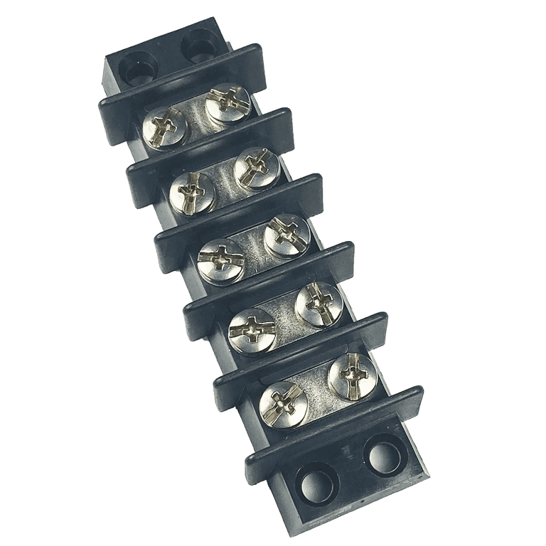

Then I would use one of these or something similar (if practical) to split the wires and connect to the relays.
Amazon product ASIN B08BDS8L3N

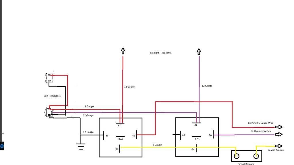

I had a request a while back to do a thread on headlight relays. It's been done before on here, and I'm not doing anything different, although I am covering a relay for the headlight motors too.
You'll need two relays. As I always recommend, go with Tyco/Bosch relays. Don't scrimp and buy the Chinese knock-offs. I buy them from Amazon. Best deal I've found for genuine Tyco relays.
Amazon.com: Metra Install E-123 Bay Tyco Relay 12 Volt 30 Amp Each: Car Electronics

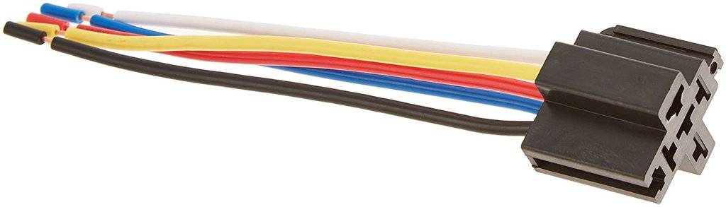

Next you'll need two sockets. These are available on Ebay or Amazon.
Amazon.com: Absolute SRS105 5-Pin 12 VDC Relay Socket Interlocking Style: Electronics
A 30amp circuit breaker can come from any parts store.
Some 12 gauge wire. To match the existing wires, you'll need black, red and purple. Some 8 gauge wire in your choice of color.
Some connectors as needed.
Universal GM Chrysler Ford Female Terminal Connector 14 12 AWG 25 Pack

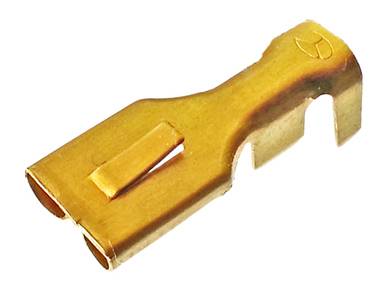

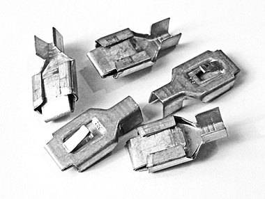

Two bags of Packard 56 connectors. These are the wider connectors for the headlights.
.3125 Wide Packard 10 12 AWG Female Lock Tab Terminal
Here's how it's wired.
So the .3125 Packard connectors are incredibly hard to locate. The vendor in the link says "out of stock". Would it not be a good idea to dremel a bit of the male spade off the headlamp in order to utilize the very common .25 (6.3mm) width female terminals with the lock tabs? Also for clarification, we should be reusing the 2 prong and 3 prong factory insulators that connect to the backs of the headlamps correct?

You can figure that out using the wattage of the bulbs and ohms law. IIRC, low beam bulbs draw 55 watts and high beam 60 watts. Don't forget to double it (2 sets of lights).
What you are aiming for is minimal voltage drop from the source to the headlights. There are other reasons, like taking the load off the switch, bulkhead connector and the old wiring, but by doing those things, it still results in minimizing voltage drop for brighter lights.
IMHO, the #12 wire is probably overkill. The factory feed of #16 wire for 2 headlights did the job, but what I've done is feed the individual lights with #12 wire. Do some math and you'll find it's probably more than you need. But I'm not worried about saving 45 cents per car like the factory did, and I error on the side of larger wire. Remember that wire that's too big will never hurt anything... But wire that's too small will.
I wouldn't do that. I'd push on the smaller connectors first. (had to do that once, so it does work, but not really recommending it)
I reused the insulators.
