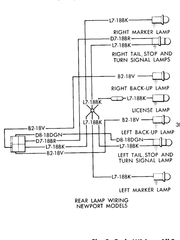

    I am getting ready for my 68 newport to be put on the road for the first time.... should I have any tail light on, when the light switch is in the 1/2 position? I do have front parks, but the rear only has lights when the switch is all the way on, or when brakes or turns are activated.... I would think that in the 1/2 position, the rear would have something illuminated?

    They should be on either in park and with headlights on.
    Time to trace wiring........or check the switch

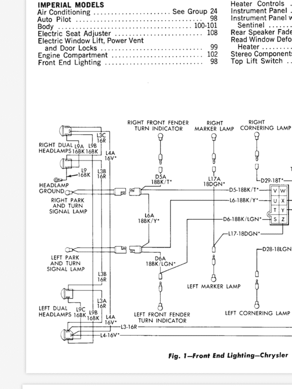

    My shop manual wiring diagram doesn’t list “park” as a function of the rear lights.... the front lists both park and turn... it’s not too clear, to me.... but thanks.

    "Park " I was saying in layman's terms and may not be lireral in the FSM.
    Anyways, since you have the wiring diagrams, rrom the headlight switch, follow the wires that feed the taillights' "park lamps".
    Btw there is a fuse in the circuit for them and check it as well.
    Check the tail lamp connector in the driver's kick panel for moisture and corrosion.
    But I am leaning towards a bad headlight switch.

    Black is park lamps in tail lights
