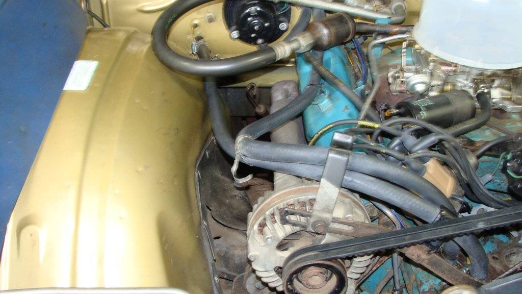

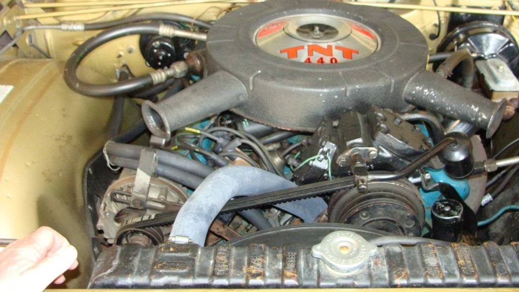

Hi, I'm looking for a couple of pix, heater hose routing on 68 Chrysler with AC, I've seen a couple of different example. thanks for the time. mike
By observation, there is not one specific routing, but one which is generally accepted, with variations as to model year and the particular engine option. The FSM details this very well.
Enjoy!
CBODY67
Looks about right. I would shorten the hose on the valve cover so it is not above the exhaust manifold. Make it stay more over the valve cover from leaving the from bracket on the alternator.
FSM is NOT clear, if it was I wouldn't have asked, FSM show tubes beside, rather up and down, if that makes sense, 413, I will look at that. thanks
Check out post 58
after inspecting mine, I have the outboard hose mixed, top should be bottom and vise/versa, some how the "inspector" miss that.
I believe Vans Auto sells the band that retains the heater hoses to the valve cover. There is an a/c and non a/c application. That will give it a nice factory look.
