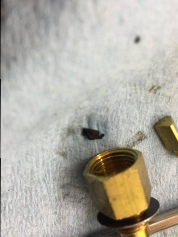

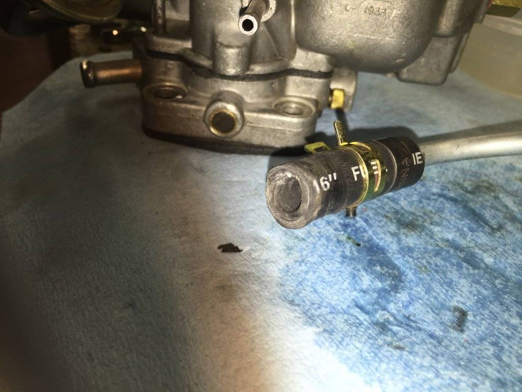

I tested the fuel pump and it failed the test 2 psi tops...
I had purchased a replacement today so switched it out
Also tackled the flooding issue
Found a pice of fuel line had broken off and lodged itself in the needle n seat
I changed the fuel line pieces attached to the filter
To top it off I disassembled the carb to trace my steps and discovered that I had installed the accelerator pump check ball into the metering valve port by mistake reassembled the carb
Reset the float level
