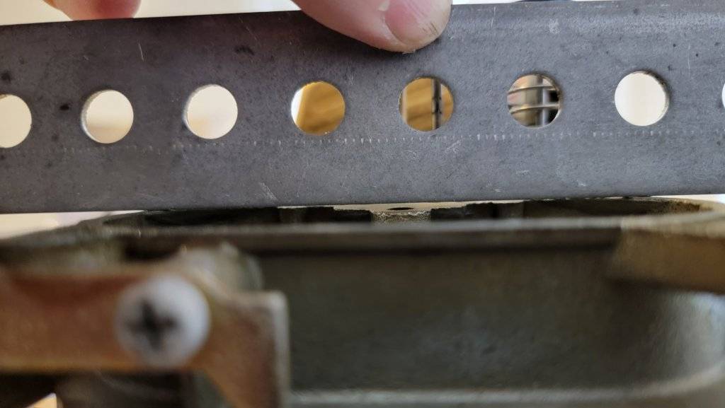

You increased timing to 25 BTDC??? If it is the warping airhorn problem, a carburetor kit regular rebuild will not solve the problem.
Usually, it takes about 9"Hg to activate the vac advance. The ported vac port should have a good bit less than that. Idle speed should be closer to 700rpm. Check the emissions specs decal under the hood.
When the air horn warps, fuel economy will drop significantly. Very similar in amount to if the vac advance isn't working . . . whether driving in town or on the highway. The choke plate should hang a bit on the air horn as it closes, which will leave a shiny spot on the air horn. No measurements are known to exist, but using a straight edge to look for warpage is all that's needed. You can use two air horn gaskets rather than one, as the one in the TSB kit was thicker and softer than the orig gasket supplied in the carb kits back then. Best to look for clues that it IS warped before disassembly.

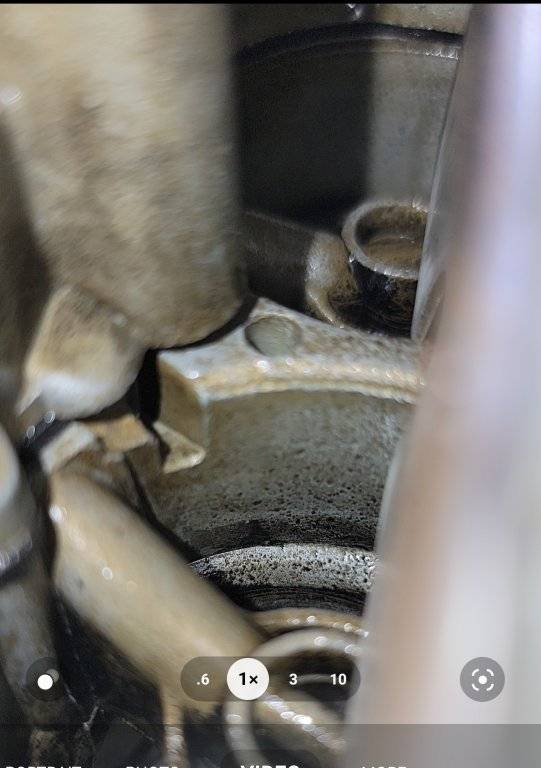

The advance is probably not actually 25, so I guess something has moved. I usually tune timing by ear anyway. No pinging when you step on it. Cold start was perfect this morning. Didn't yet drive to check for hesitation.

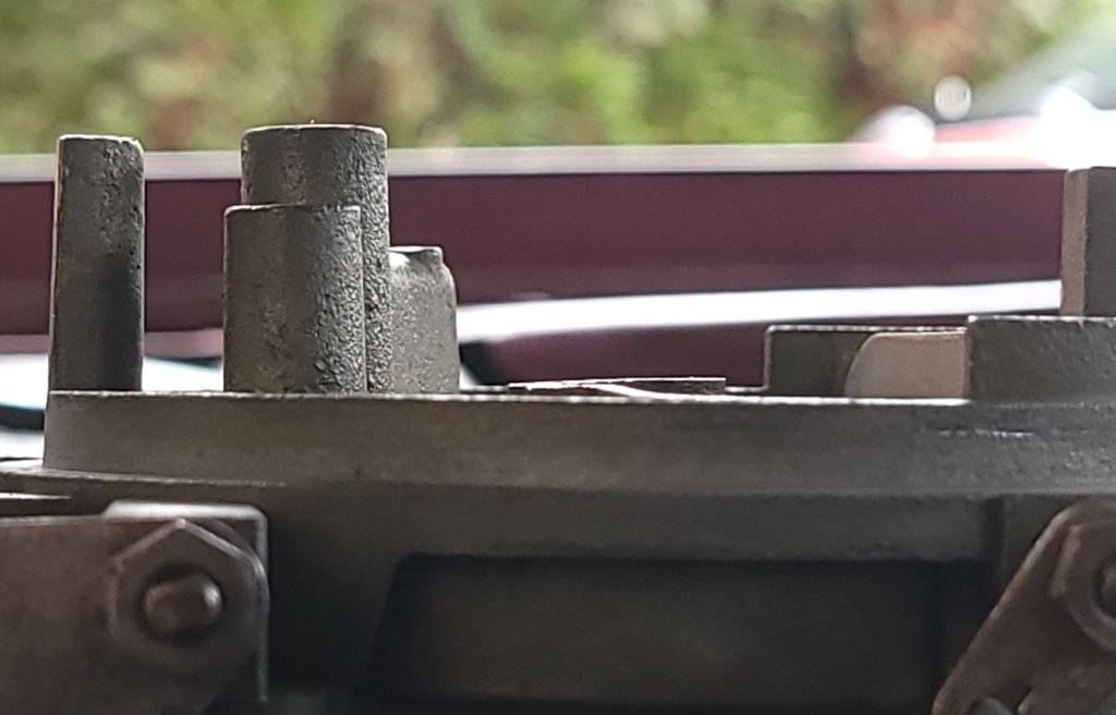

I'm guessing this gap here is from warping. Does the carb need to come out or can I just remove horn (2 barrel). It looks like several Philips head screws holt horn on. I have a new gasket and will un-warp. Screw hole in middle of horn seems to be stripped as well. I assume a previous owner attempted to fix it by tightening...
Looking at it, I don't think this is all the fault of owners overtightening. The air filter housing is heavy and has a LOT of leverage on that attachment point while it vibrates or wobbles as you drive. Bad design as others have said.
As a few of you suspected, there it is. So I have two or three issues. Warp, bad vac advance, and my timing mark is out of whack. No big deal on the third. I'll get to work on the other two. Thanks all for the replies!!

Just an update to close this little saga. Changed alternator (unrelated to hesitation). Changed vacuum advance on distrib. This explains why I had 20+ advance at idle bexause the vac advance was completely stuck. And I fixed the horn, but would like to add a bridge.
