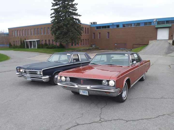

Since I handle both a 66 and a 68 let me tell you the differences.
Mechanically underneath are durn near the same.
The dash and underhood wiring is slightly different. Location of starter relay and length of related battety cables.
Trunk light in a 66 different location.
As alrwady mentioned steering columns different.
Door guts/ window mechanisms the same but vent wing wi dows are different by style but still interchange.
Some 68's will have a return furl line depending on engine size and emissions.
66 have external washer pumps, 68 inside washer jug.
Tailight wiring different. 66 all models has 2 bulbs per side. 68 newport 1 bulb per side but 309 and NYer has 2 per side.
66 4dr's have metal center pillar panels...68 plastic.
Seatbelts are different. 68 saw retractable mechanisms vs the spring loaded loopy things on 66 belts.and also shoulder belts wrre optional in 68 and related belts are totally different to 66.
66 saw bekts for 4 passengers. 68 you could get belts for 6. 9 for wagons
66 cruise o matic was a frankenstien electro-mechanical apparatus that worked ok.
68 cruise control is a 1 year only contraption that was not reliable.
66 headlight switches are the common style vs 68 toggle switches.
All toggle style switches can be a pain and there were a few different part numbers that do not ibterchange between 67 and 68.
68 dimmer switches do fail and can be rebuilt.
Both intrument clusters are a pain to service with the 66 being the worst,in my opinion.
66 had 2 speed and variable speed wipers. 68 had 2 and 3 speed. All have their own wiring and the variable speed has its own wiper switch.
Thats all I can think of at the top of my head.
