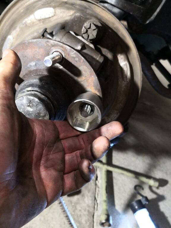

I´ve to change the wheel studs at the front passenger side as two of them have a thread
that´s toast. Removing is easy, I use a balljoint remover to force them out.. piece of cake.
But forcing the new ones in didn´t work out yesterday. I tried the balljoint remover
the other way around but it would not slip in.
A friend of mine told me to throw the studs into the freezer over night so they shrink just a little bit which would be enough. I´ll try that one
Are there any other ideas in case that doesn´t work out ?
I´ve seen videos where people use a nut and the compressor screwdriver but wouldn´t
that screw up the thread again ?
