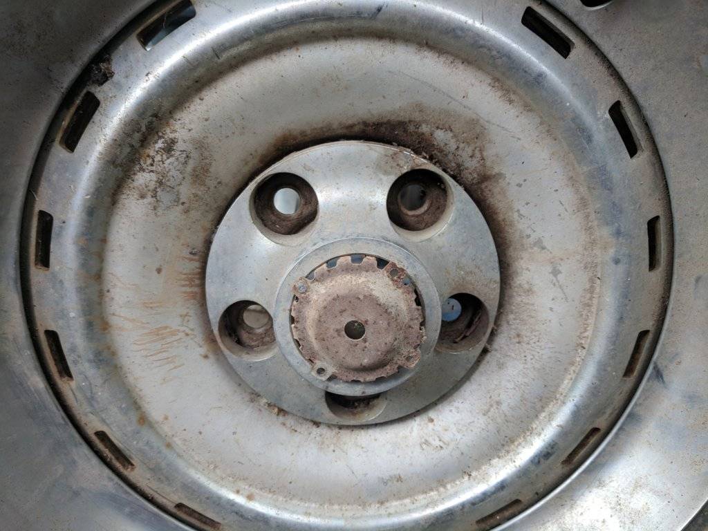

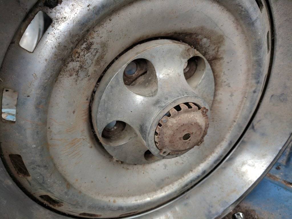

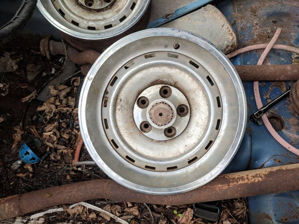

Here's some pictures. I tried to clean up the inside if in of the rims, but didn't find any numbers, but I had a toothbrush sized wire brush only.
Forgot to bring a tape measure again, but had this socket and extension, which measures 4" in length.
Not entirely accurate angle in the picture, but it sure looks like a 5 on 4.5" pattern.
Sure look like mopar wheels, even the visible retainer under that cap that's gone awandering.
They look like the chrome version of the wheels with the late, short dome style centers.
Are these of any interest to anyone here? They need to be cleaned up a bit, but the faces seem good, and they have the trim rings and caps, missing the domes. I can get them and pass them on to whomever wants, needs or has to have them. I can get better pictures too. I saw them and thought of FCBO members right away. I can start a for sale thread if needed.
Stiff wire brush on angle grinders should clean up the back side of those nicely.
