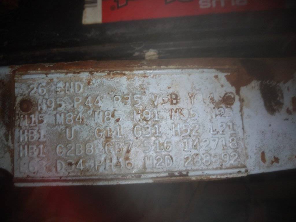

FENDER TAG FUN!!
It says E63 is 335HP 4bbl 383
But it also shows M2D is 190HP 2bbl 400
Also, my wagon has no stripes and I am pretty sure I've got original paint...
...and I don't see any bumper guards either...
...and the rear A/C must be one of the unknowns..
So what is the deal?
Below is the MyMopar Decoder result.. Am I doing this correctly?

Am looking at the Nick's garage listing and here's
Some more info for you.
At least the H52 is correct, the others "may" mean something different on your wagon as the same codes meant different things at different times.
H52 is dual air conditioning
L21 is cargo lamp
M15 is upper door frame moulding
M95 is assist handles
According to an article on max wedge.com the M2D = M engine type 2 = year in this case 1972 D = factory where engine was made.
Hope this helps you.

yes it helps thank you. I hadn't noticed the bumper guards...I was expecting something horrid but they are actually well blended with the bumper...the rear guards seem to be built into the steps?
So, the E63 (383 4bbl) doesn't mean I have one? I'm pretty sure I have the 400 as the air cleaner says so but just curious.

yes it helps thank you. I hadn't noticed the bumper guards...I was expecting something horrid but they are actually well blended with the bumper...the rear guards seem to be built into the steps? They probably were.
The E63 suggests it's the 383, but looking up Plymouth Fury for the year your wagon was built, numerous engine options were available. The forum experts should be able to advise you how to tell what you have. Possibly the air cleaner was replaced with the one you have??? Anything could have happened during the last 47 years.
