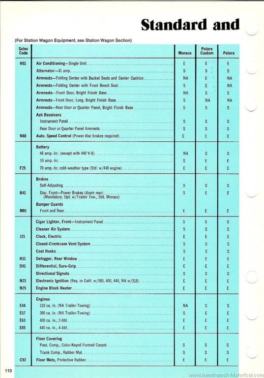

The E63 suggests it's the 383, but looking up Plymouth Fury for the year your wagon was built, numerous engine options were available. The forum experts should be able to advise you how to tell what you have. Possibly the air cleaner was replaced with the one you have??? Anything could have happened during the last 47 years.
In 1972 the 400 replaced the 383 so unless its a really early build it does not have a 383.
Perhaps there was an overlapping period between the time the tag was prepared indicating a 383, but when she was built the change had occurred and a 400 was installed. If so, I wouldn't imagine any attempt to produce a new tag with the correct engine as it wouldn't have been an issue, mechanics would recognize the 400 and use the correct parts.
After 47 years, having a functioning engine is the main thing, and fortunately you seem to have that.
I believe I have a 400. But I am curious as to why the E63 is on the tag.
Tag codes changed over the years and certain tag codes mean different things on different car lines. One code may mean one thing for an A Body and another for a C Body. I have found that the information available on line is not complete and does not focus on C Body Body tag codes. Without personally spending some time decoding your tag I can't comment further.
What is the year and month on the driver's door VIN sticker? If it October 1971 or later I would be pretty certain that it is a 400.
Because it's the correct code for a 1972 400ci engine.
