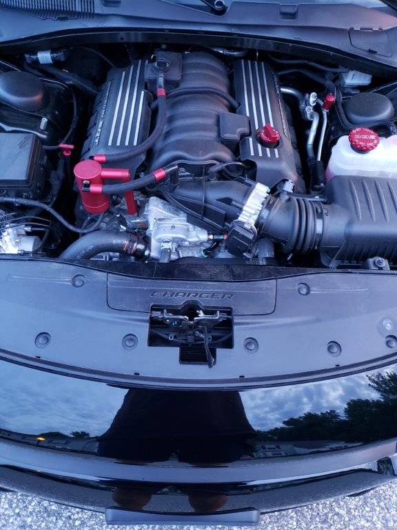

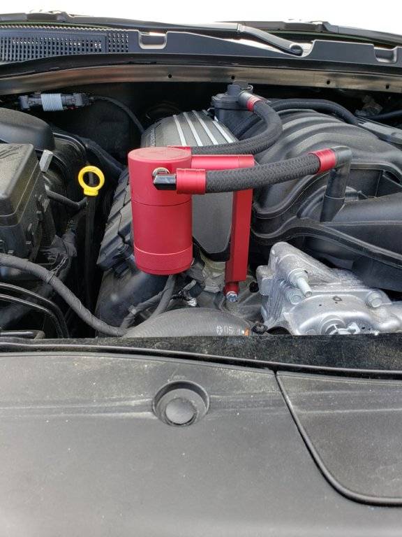

Do you have a catch can on your 6.4L yet? I would highly recommend one to prevent your intake manifold, throttle body and exhaust valves from getting all gummed up from the blow by that these engines produce.
I was looking at them but was concerned about potential warranty issues. Did your dealer notice it when they were troubleshooting your blower motor?
They all know better. A catch can will not void any warranty. I'm surprised that Mopar hasn't added them by now. I guess the few pennies it would take to buy millions of them is too much of a cost. I've had mine in for 3 oil changes and the blower motor so far. I have a bunch of non factory stuff on it already.
I also have the Billet Technology engine dress up kit on it.

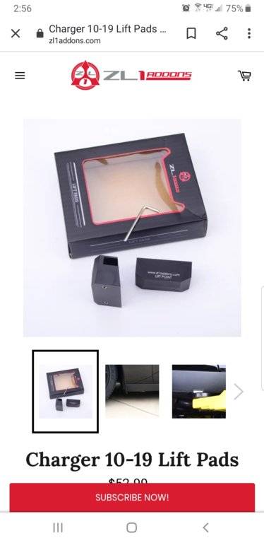

I also added the ZL1 Addons lift pad kit too. If you haven't figured it out yet.... it is difficult to Jack the car up. The lift point is the pinch joint and you'll just crush that area using a floor Jack. You will need this kit for the front end. The rear has pads that you can jack up.
The pad goes over the lift pad and there are 2 set screws that you tighten to keep them tight on the pinch joint.
$53 for something that shouldn't be so crappy in this day and age? I folded one of the rear points, they are ****. Why in the hell haven't they come up with a solution that is solid and works? I can't understand it. I can't spend $53 on that simple an item, I can probably make my own. Thanks for the idea!

The ZL1 Addons lift kit will definitely make jacking from the side easier and will save the rocker panel from getting crushed if the floor jack isn't lined up properly.
The placement of the lift kit for your Charger at the pinch weld is where I usually place the jack stand.

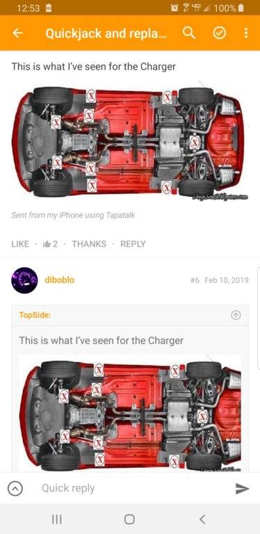

I'm having problems rolling up on a drive on lift with hitting the splitter. Nothing easy on these cars...
This diagram should be exactly the same for a 300.
