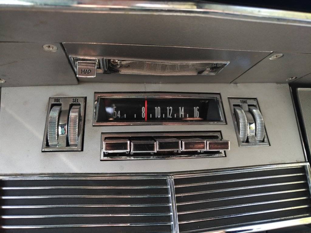

so i bought the Redondo Rt from retro mfg when the tech guy said it should fit and of course it didnt with that convex paeak in the center of the surround... so i ordered the Tayman electrical rebuild and it works great, blue tooth, am/fm/ phone etc. I highly recommend them- nothing better to keep the stock radio except with updated technology. Highly recommend. here's a picture.

Not surprised that it didn't fit and they told you it would.
I had Gary Tayman do two radios for me now and I can't say enough good about the service and the quality of the conversion.
