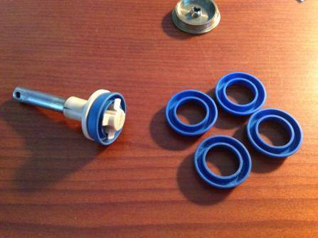

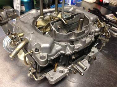

I like my T-quad. 850 CFM and it idles smooth. All of the idle problems I had previously were the fault of the engine, distributor, and wires. Not to say I haven't had carb issues, though.
The T-Quad spent some time on the bench the past three weeks. Hard starting cold and hesitating when cold. Ran well when hot, though.
As expected, it was the accelerator pump. It's not the carb's fault, the fuel is to blame here. The "new" fuel is causing the plunger seal to shrink. I am fortunate to have a 50+ year old carb shop less than 10 miles from where I live, complete with "old guys" that know how to work on stuff like this. They were able to supply me with new pump seals (or cups) which solved the problem. Also had some insight on how the new fuels are attacking various parts here and there...

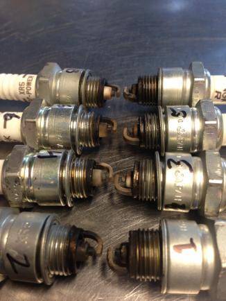

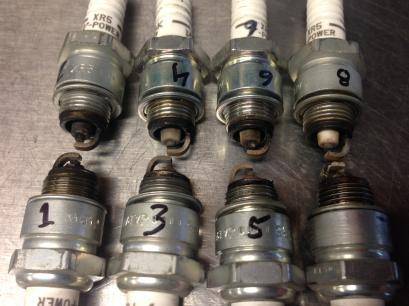

Yesterday I found some fouled plugs, however. Might have been a too rich condition, not sure yet. The jets were changed to a bigger size temporarily to (unknowingly) compensate for a vacuum leak. Now that it's all fixed, we'll see how the plugs do...
