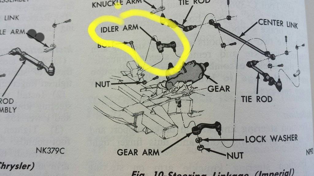

Guess the idler arm is pretty loose on Big Red...any thoughts on getting this part from anyone in the US?

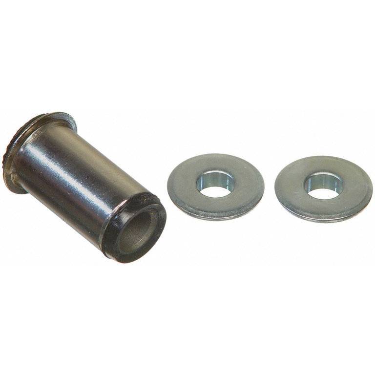

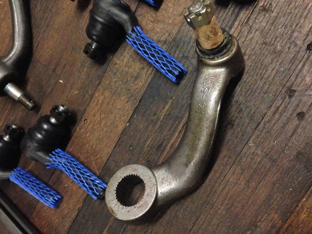

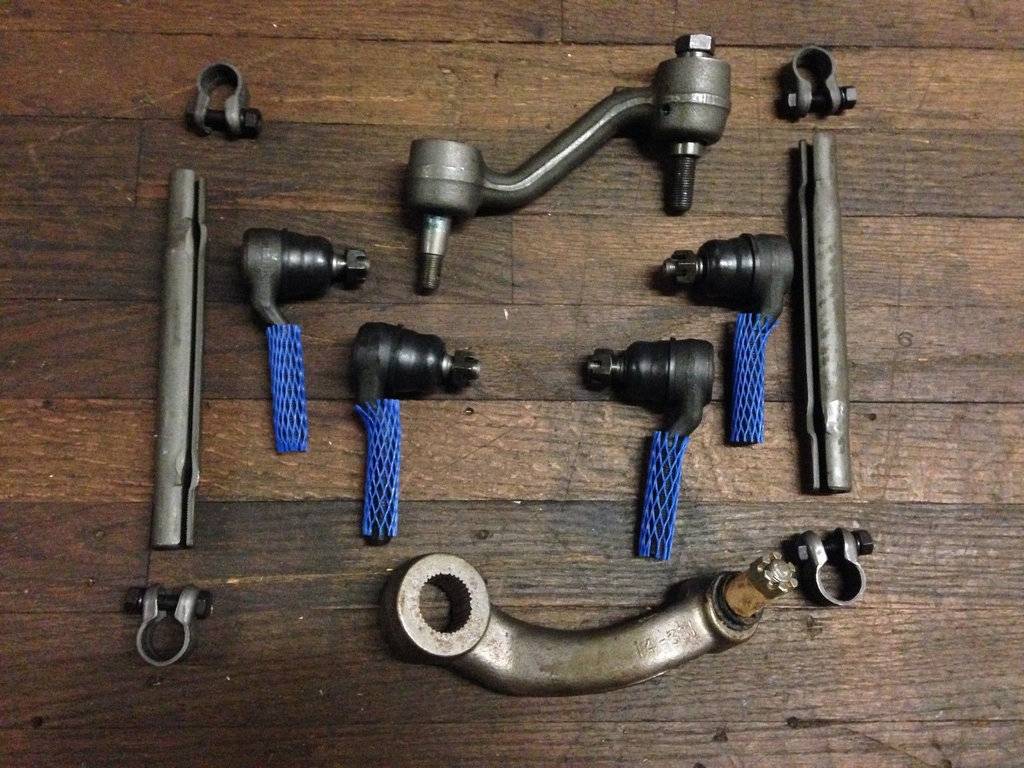

The bushings on Ebay for 20 bucks...wonder if the fix can be that simple...that would be great...I thought I might need complete arm like below which appears to be part of full kit for about $400.00.

can confirm. have repo idler arm with those 2 washers ^^. didnt fit for crap, but finally installed after much wailing and gnashing of teeth.
The bushings on Ebay for 20 bucks...wonder if the fix can be that simple...that would be great...I thought I might need complete arm like below which appears to be part of full kit for about $400.00.View attachment 143329 View attachment 143328
That is a pitman arm you have a pic of there.
The idler arm is the similar looking one above it in the kit picture.
