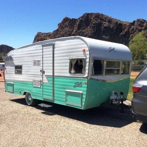

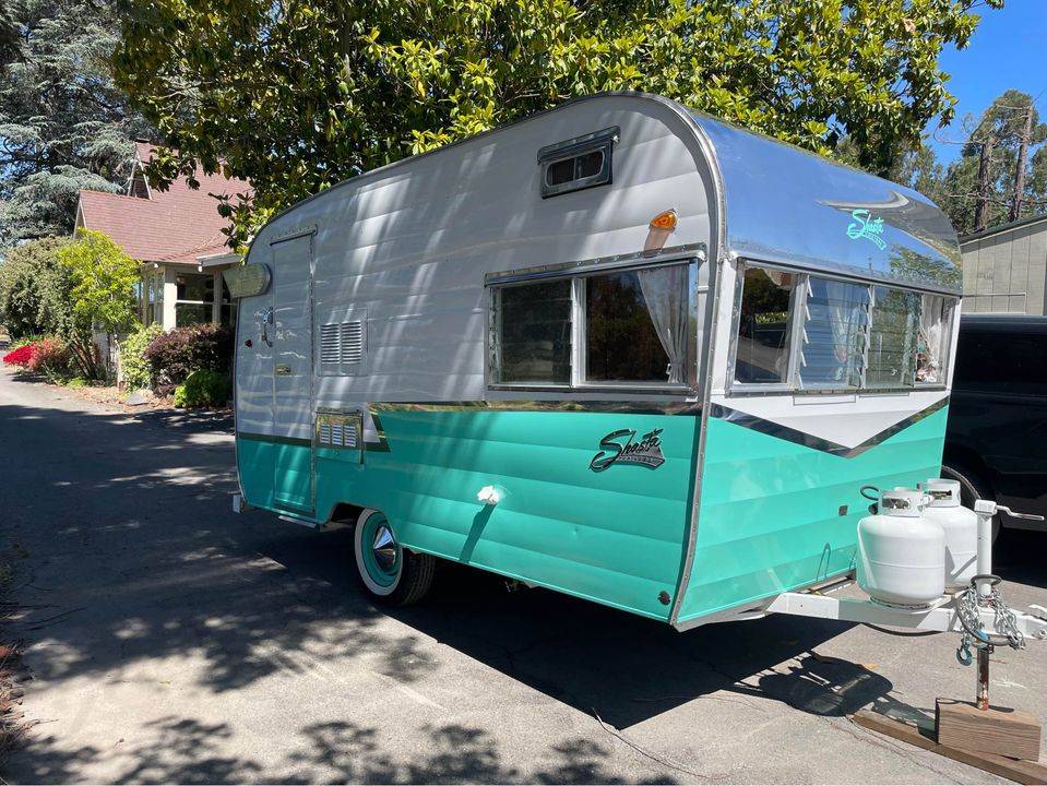

Problem solved! I found out that in 2015 Shasta did a re-issue of their 1961 trailers. Nearly identical, but with modern components including a fully equipped kitchen and bathroom. I'm going to keep my eyes peeled for one of these units.

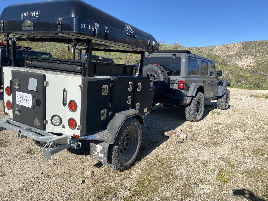

Wow! That’s a lot of great information and advice. I’m no stranger to trailers and towing however I’ve never done it with a regular passenger car. I have a 2022 Jeep rubicon that use to tow my overland trailer and I have a class A motorhome that I use to tow my Jeep or bronco. I have a wireless electric brake set up that works great.
I like flat towing, and your Overland appears to be balanced right nice behind your Rubicon. Looks like big fun.

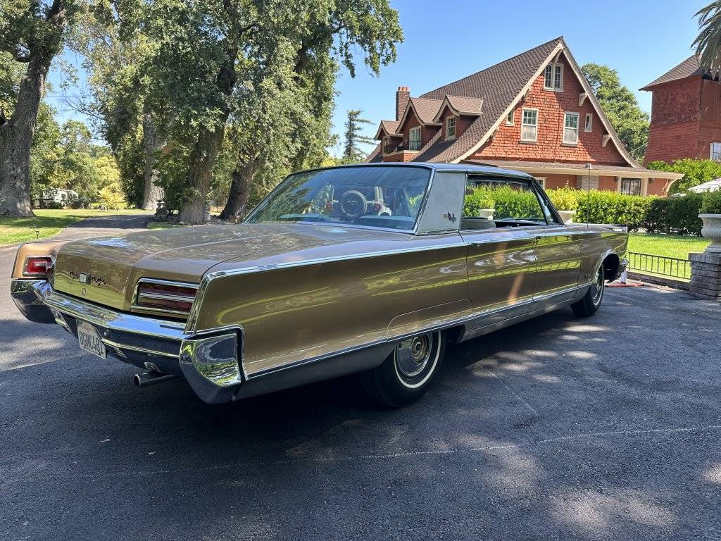

As I am planning out our cross country and route 66 trip next year, the thought of towing a small vintage trailer is intriguing. Our 66 New Yorker is equipped with the 350HP version of the 440 and is completely stock. Do any of you see any issues with towing a small vintage trailer. I'm thinking of something in the range of a 15 foot Shasta AirFlyte. Any special modifications need to be done to the car?

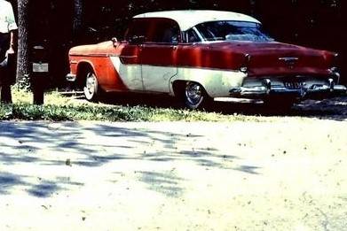

yes wel folks was using drum brake cars for yrs to pull trailers . my dad had a Plymouth savoy with a slant 6 with 3on the tree we pulled a camper all over the USA with no problems ether folks r spoiled with disk brakes noow or 4 wheel disk brakes they dont now how well drum brakes really worked
