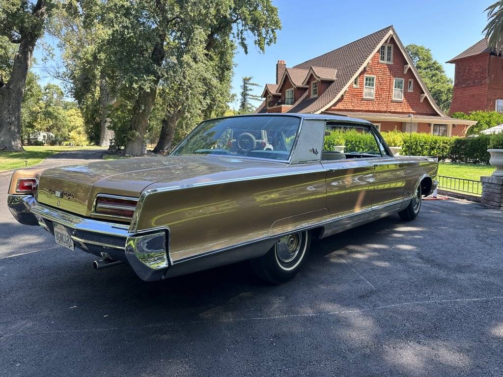

As I am planning out our cross country and route 66 trip next year, the thought of towing a small vintage trailer is intriguing. Our 66 New Yorker is equipped with the 350HP version of the 440 and is completely stock. Do any of you see any issues with towing a small vintage trailer. I'm thinking of something in the range of a 15 foot Shasta AirFlyte. Any special modifications need to be done to the car?

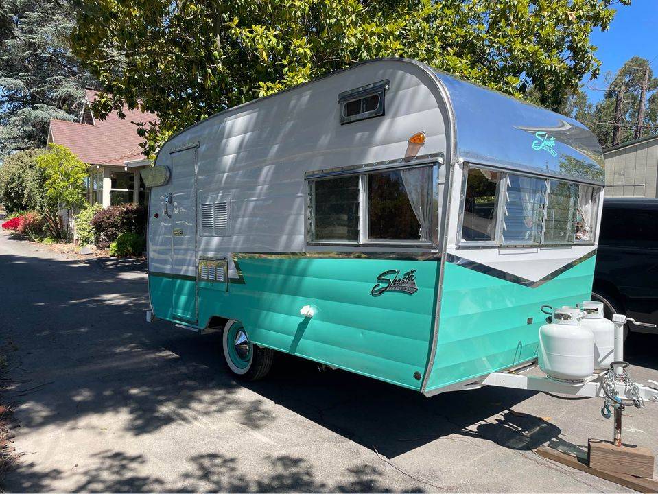

Good to know! The trailer I'm looking at weighs 2,300 lbs.
Consider a new retro look camper trailer instead of an expensive restored vintage camper. There are a lot of things to look at on a vintage trailer. You may find that the 15' Shasta type trailer is going to be too small. I would advocate find a used receiver style hitch for you car or having one made and using a weight adjusting hitch set up. Trailer brakes are a must for safety so you will need to install a trailer brake controller. Don't even consider a trailer with surge style brakes as there is no way to activate them if the trailer starts to sway. I have done a lot of towing in my life of various sized trailers so feel free to reach out to me. IMHO, something along the lines of a 20' trailer with dual axles may be a better option.

A nice retro trailer , Shasta ,Serro Scotty, Boler are just as expensive as the retro car.

That Shasta shown above is probably 10 to 12 k in Canada. Nice trailer!
